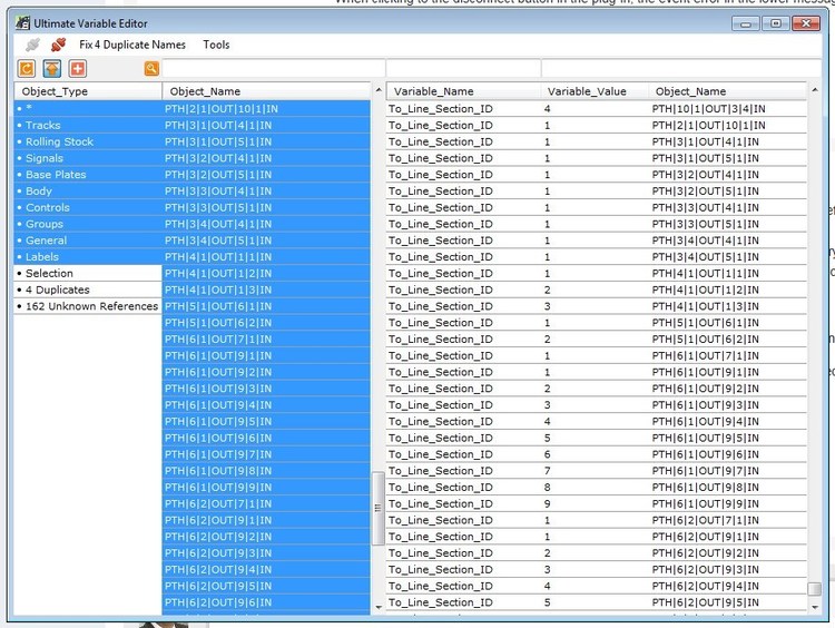

Hello Trevor,
thank you very much for this great plug-in. It works excellent with global variables. But to see object variables, I must select every time the specific object. Would it be possible for you to display also a "collected list" of all object variables, so that also these ones can be selected in whole for deletion?
In addition, I have got an error when trying to disconnect the plug-in from the TrainStudio layout:
When clicking to the disconnect button in the plug-in, the event error in the lower message occurs, and the plug-in will be closed with the upper message.
Best regards
It should load everything when you first start. It only shows the globals first though by default.
Learn to use the search functions, they are quite powerful. Note there are three text entry boxes to search the name of the object, variable or variable value. If you have a common variable name on lots of objects, search for that in the middle search box.
Also. you can select multiples in each column further refining what gets listed.
If you really want everything, select everything in the first two lists (except the specials in the type list)
And yes, disconnect handling may be a bit off. I usually just close the window. Disconnect does not do much anyway.
