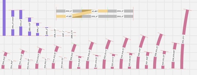

Hi Oliver,
thanks for your Information, I have the mentioned resources available. I will try my very best to get best results.
regards, Henry
