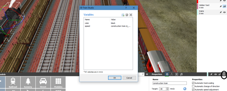

ScreenShot_20160921201032.pngobject variables are set by clicking on the object, then clicking on the bars at the right edge (Circled in black here) and then entering the name and value of the  variable.  I eScreenShot_20160921200952.pngntered a variable  "Color" and value Black.   I cannot currently make it read speed.
Here the EV shows 2 global variables,  prestopper and stopper that were created by an event and they change.
there are also two object variables
(Object name.variable    value)
construction train.color   black   and
construction train.speed    (some nonworking garbage)
prestopper and stopper would be referrenced with a $
