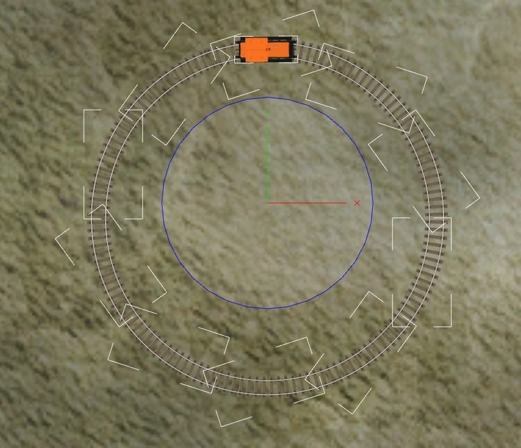

That's why I use a loco on a circular track as a timer in my controller Easy.
I use that instead since,
a) FPS depends on what you have in view. and whatever else is happening. It varies frame by frame.
b) With faster simulation rates you usually want to do your thing at the appropriate speed.
According to NEO I could use an MBS timer object instead... but I am not convinced that works quite as advertised and isn't controllable via the plug-in interface.
Obviously the timer track is a LOT slower than FPS... but with mine running at about 5 track entries per second it seems workable, though I could go faster.
(I figure NEO has already done the FPS - Distance travelled math so using the motion of a defined object makes sense.)

Remember though, Frame Rate is NOT REALLY a good clock to use. The MBS software attempts to refresh the display as fast as it can so it not only varies by frame but also by computer.
Today I switched my controller over from using a cycling locomotive to use an MBS timer which IS synchronized to the layout motion...(or seems to be close enough).
It works ok, but initially getting the timer started requires some event code which is a not exactly a "pure" solution.
I set the timer to 0.2S and use that event to time things. That's 5 interrupts per second which is a bit low really... but.. at four times simulation rate that goes up to 20/s which is starting to get too close to the slower frame rates, so I am reluctant to go any faster than that.
