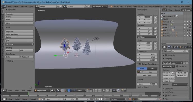

file format(s) are blend, 3ds, and what looks like wavefront.  I just downloaded Blender 2.78c , but am very new to 3d modelling.
the file appears to contain 3 trees.  I'll include some screenshots, and maybe someone can tell me what to do.
Hi Curt,
... can you make a .zip file and put it in here (or send the .blend file to me as an e-mail)
... so it's easier to explain the steps (i would do...)
