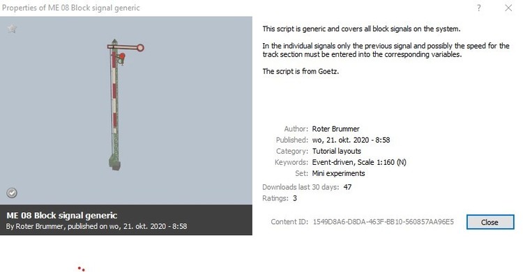

ME 08 Block Signal Generic is found in the catalog
As you can see it is contributed
by Roter Brummer and the script is from Goetz.
The signal has a variable, type table, you can set another speed as value in the second entry. (now 80)
The 0 and 1 in the name will later in the code correspond with the state of the Signal. Do not change them.

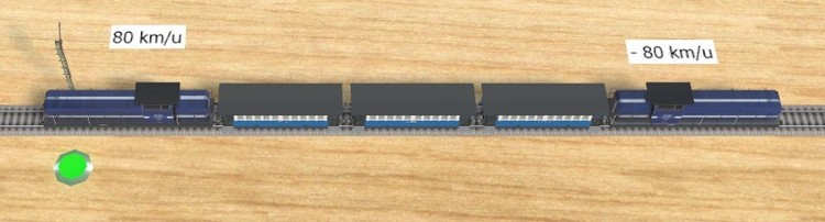

The solution for finding a pushing vehicle works also if you use front-tail locomotives.
Both vehicles are detected. And both vehicles their speed is reset after the signal changes to green.
Signal green situation :
Train situation :
But that’s nice, it works fine. The whole train resumes with a 80km/u speed as we wanted.
