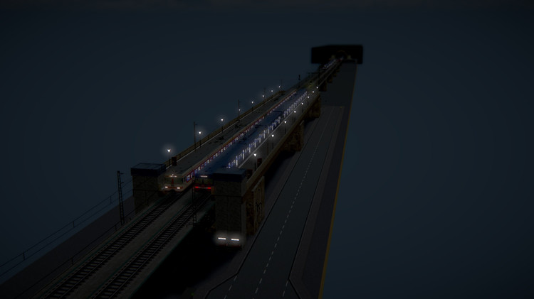

So, I have this very simple layout that is a single station on the middle of a section of elevated track the sort of thing you might see in New York, or Tokyo, even London has some. I imagine a place like Munich might...? Anyway there are 10 brightly coloured Urban Mass Transit Vehicles zipping back and fourth between two fiddle yards that each have 4 tracks, and the fiddle yards generate a random number 1-4 to decide which track to release, giving a realistically unpredictable sequence of trains.
