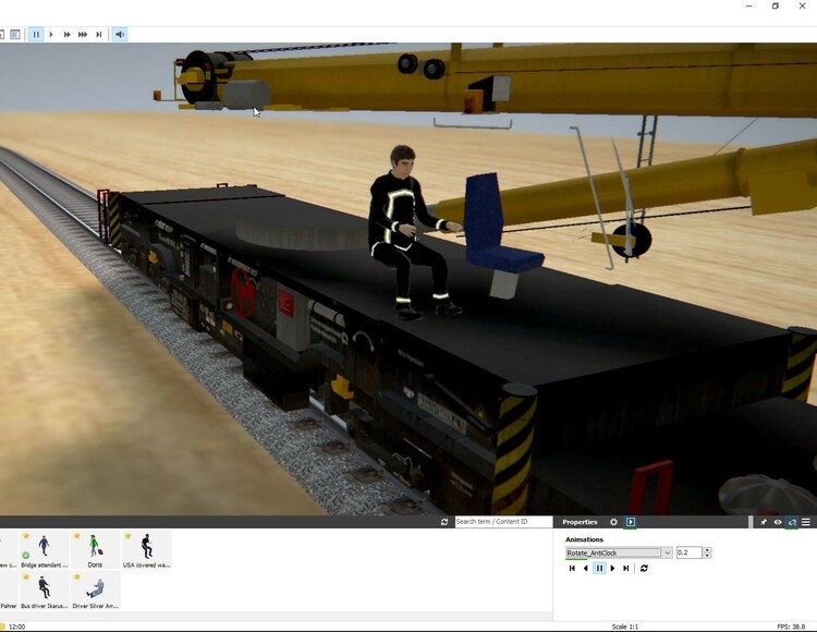

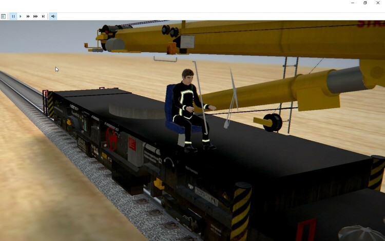

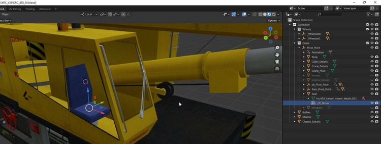

I've a Contact Point (_CP_Driver...) created as a Child to the seat of this crane; the seat pivots as a Child of the Crane Body. The CP is an Empty, from Blender. The Operator (from the catalogue...) snaps onto the CP correctly, but doesn't follow the rotation of the Crane Body. Here's the Blender hierarchy, and screenshots of the Operator snapped onto the CP, and the Body rotated, leaving the poor man in mid-air. I've obviously missed something simple but important, but what..? Thanks in advance for explanations and solution.

Hallo @Dad3353,
der Kontaktpunkt auf dem Kran muss "_CP_Target" und nicht "_CP_Driver" genannt werden.
Menschen/Ladung haben den Kontaktpunkt "_CP_Source".
the contact point on the crane must be called "_CP_Target" and not "_CP_Driver".
People/load have the contact point "_CP_Source".
