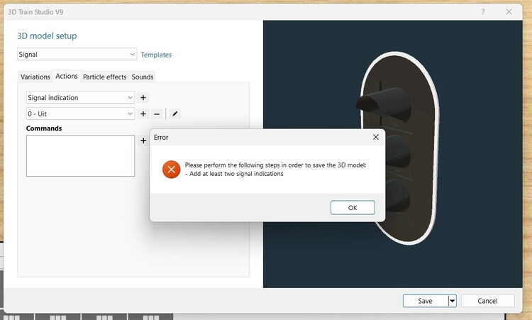

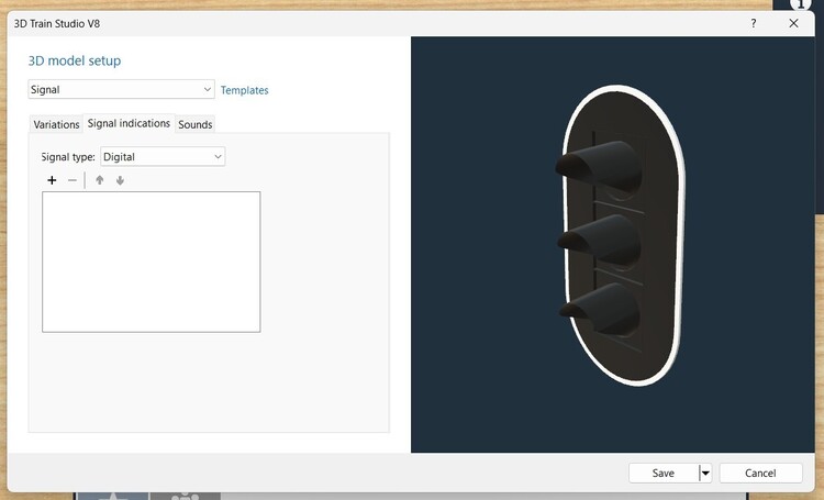

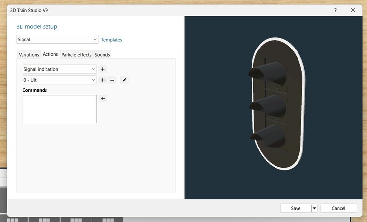

I made my own train and tram signals. In V8 I had no problem to import them, but in V9 it doesnt seem to work. I continue getting an error message.
See the pics ... one of V8 and four of V9.
Thanks in advance
Regards Raf

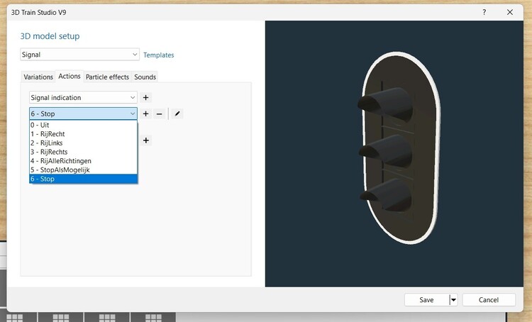

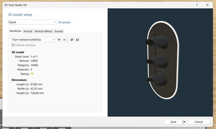

you must add each Signal indication from the list shown within picture 3 above by clicking to the "+" sign at the right of the entry "0 - Uit" in picture 4. Then, you can select another entry of the list from the picture before. Make one entry for each signal state (in the correct order). And then, you can save the model into your catalog. Please take into account, that your signal needs a further LoD entry (Level of Detail), because the limits of polygons and materials are exhausted within your model (limits are 5000 polygons and 3 materials for the lowest detail level).

Hi Bahnland
Thx for the help... worked now.... I know about the polygons ... thx
