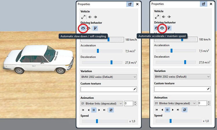

Hallo / hello @Leslie,
aktiviere die beiden markierten Buttons im Eigenschaftsfester des Fahrzeugs, um die Geschwindigkeits-Anpassung an das vorausfahrende Fahrzeug zu aktivieren.
Activate the two highlighted buttons in the vehicle's properties window to activate the speed adjustment to the vehicle in front.

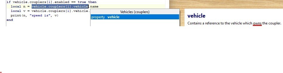

I found a mistake, @Leslie
The condition is incomplete!
It should be
if vehicle.couplers[1].enabled == true then
and as @Phrontistes rightly pointed out:
couplers[1].vehicle references the vehicle which owns the coupler, not the vehicle connected at the coupler
