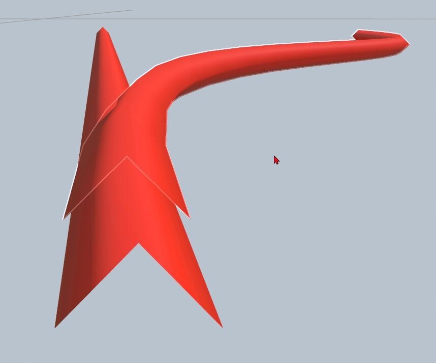

Hello,
the connected picture shows route fitting in MBS:route.jpg.e4dbea2a2d7c28b6bd8afde4386c6307.jpgUpper picture contains 3 routes which can be combined but need strict to fit. Lower picture contains 2 routes which allows you much more freedom in planning but does not work currently. I suggest to re-think philosophy if possible.
Working method: at route end program searches for free route at near. Not only free route edge.
Of course if you are near to the edge, fitting must be pull you there so edge snapping will not change.

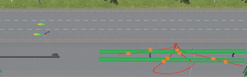

I plan a route system with possibility of change lines between red and green lines at orange points.utterv.thumb.jpg.8d7ba919d87401712aaac19605a5e1d1.jpg
Not only 4 lines but at least 8. What is your suggestion to manifest this with acceptable work and material cost?

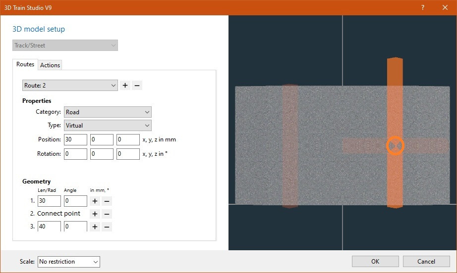

Track contacts are available for this application. You can position them anywhere and work with them...
Or what do you want to do with the (new) contact point you want?
