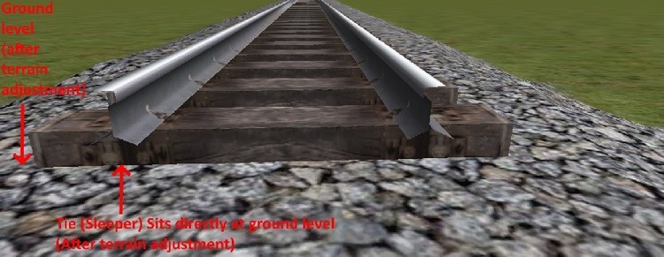

Let's take this one step further.  As in first post, I started at 10 mm and adjusted as in first post.
when I get back up to 10 mm, the track sits exactly at the terrain level, but if you have ever walked prototype tracks,

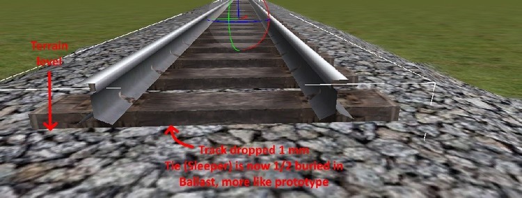

you will find that the ties are partly buried in Ballast.   I've walked this very track, and found this to be so.
the solution is to drop the height of the track by 1 mm to 9 mm.   The ties are now partly buried, and it looks more like Prototype.
