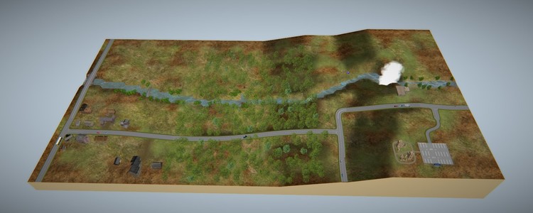

simonjackson1964 Geschrieben 25. August 2020 Geschrieben 25. August 2020 I'm so bad at doing scenery that I decided to do a layout with just scenery, to see if I could make it look good. I have to say I think it's okay as far as it goes... But then I decided to put cars on the roads. And I decided to put a timer on the junctions to make them change at "random" and direct the traffic down different roads. And I encountered two problems. 1) In order to prevent the road switching while a vehicle was on it I used the simple condition "If any vehicle is on track junction 1". Which works fine, except a semi trailer is not a vehicle, apparently. The truck was for ever loosing its trailer at the junctions. In the end I gave up and deleted the trailer. Does anyone have a way of preventing this? 2) The invisible men from Mars... Okay the spacers. They are vehicles. They are great for keeping the traffic spaced out, but they don't stay where I put them... The instructions say that the spacer should be placed between the vehicles and the clutches deactivated. But should the spacer be driving itself? Should the clutches on the actual vehicle also be deactivated? Should the vehicle be pushing the spacer? Or should the rear clutch on the vehicle be active so it pulls the spacer?
