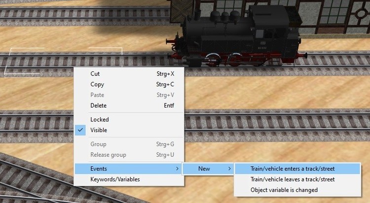

Goetz Geschrieben 28. August 2020 Geschrieben 28. August 2020 Hello Douglas, Writing in English is okay. And offering a translated text is a nice courtesy. A train should be detected when entering (or leaving) a track, regardless if it is pulled pr pushed. However, when you issue a new command to the train and set it up to affect any train on a particular track, the engine must sit on that track because it represents the train. A better tactic is to store the train which triggered the "track entered" event. Keep it in a variable and when you want to affect this train, address the train via this stored reference, regardless of the track (i.e. Track: any) Does this help or did I miss the point of your question? kind regards Goetz p.s. Which version of the train studio are you using? The event management of V4 and V5 differ greatly.

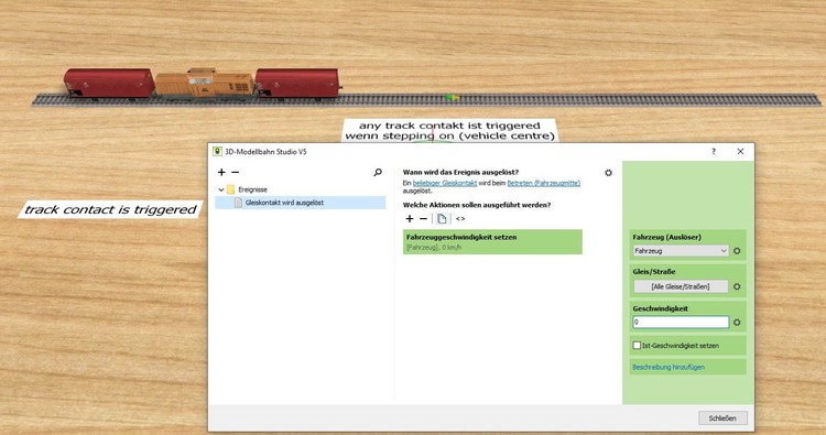

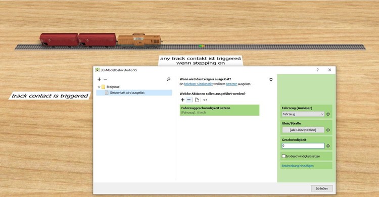

streit_ross Geschrieben 28. August 2020 Geschrieben 28. August 2020 Hello, Douglas, For both possibilities you need a track contact. You can find it under Infrastructure Railway Traffic and there the green-yellow rhombus. In case the locomotive is at the front or the end of the train, see picture 1 In case the locomotive is in the middle of the train, see picture 2. You can move the track contact to the right or left until the train stops at the right point. kind regards streit_ross
