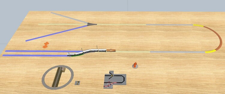

I use a link between a track and a GBS module. ( from the track to the GBS ) All tracks have the same keyword, trackswitchs another depending on their kind.
This keyword triggers the code when track is entered, a track is leaved.
Fine ... but because of the link, if I move a GBS module the tracks moves also. Other solutions ? Or a link to former topics to read ? Thanks. Herman

Testset
For a normal track :
For a 3 way track switch.
vor 18 Minuten schrieb Herman:
Other solutions ?
Use a variable.
A link groups models for the pupose of moving them together. Freight on a waggon. Driver in a car. Labelling on a signal.

This test is here since my beginning in V5 (*) I must have found that solution somewhere on the forum. A links purpose is something else as you mention.
Of course, a same approach with a variable type object will do the job flawless.
(*) I did put it away and never used it again because of the moves.
Thank you @Goetz
