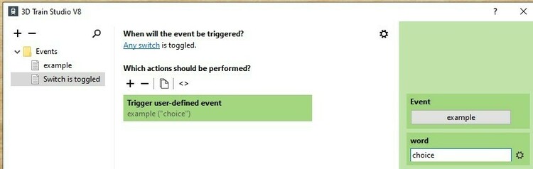

Goetz Geschrieben 16. April 2023 Geschrieben 16. April 2023 You define a parameter as part of the user event. Use the type "text" when you want to pass a word of your chosing as a keyword select this parameter via the entry "trigger" where you want to make use of the keyword that you receive when calling the user event: and enter the word of your chosing when you call the userevent in response to some other event kind regards Goetz
