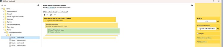

I'm confused, and clearly not using "routes" correctly. I assumed that setting a route simply meant clicking on the routes icon at the bottom of the screen,  select the train and then simply list the route by means of moving from one signal or TC, (waypoints) to another until that part of the route in question was complete. I have set the route for each train in 2 parts. One leaves the terminal and ends just before the first VD. The second starts after the train has left the last VD and runs through to the freight terminal. Each train begins once it's relevant signal has been switched. I was unaware that it was to activate said route in the EV as well. I can now see the relevant section for activate or deactivate a route but no where have I come across the defer picture that you have sent.
Once again I have attached two more screenshot of one of the routes and would welcome your further advice as to the proper method of activating both.
Cheers
Pete

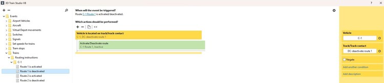

Hi Pete,
vor 1 Stunde schrieb 220hotwheels:
to take me a little while to work through all of the information
I think not only a little while. It took me a few weeks to get to where I am now.
About your EM:
So it won't work out for logical reasons. I'll describe what you're doing here, namely a pointless roundabout:
  • You evaluate the event, a specific route has been activated/deactivated – but without querying whether it has just been activated or deactivated.
  • Regardless of whether it is activated or deactivated, you activate exactly this route under certain conditions, so you either activate it for the second time (don't do it because of the stack!) or you just deactivate it again.
It may be that you have to evaluate the event Route has been activated/deactivated, but firstly you have to evaluate the condition "Route is active" (or not) and secondly you do something afterwards that should follow and do not manipulate the triggering route.
Evaluate when a train enters a track contact and then decide which route should be activated (once!).
I hope this will get you a little further.
Best regards
Phrontistes
