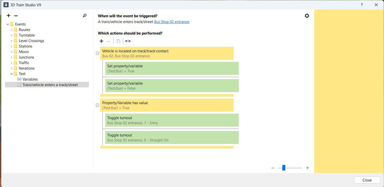

Goetz after your sugestion of using a variable, I've decided to go down that route with a boolean variable as below. This seems to work ok.
