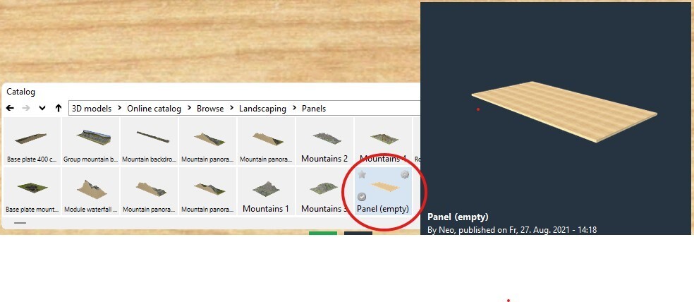

- @Neo please place a "ground" to online catalog. Currently is missing although it is an essential component.

vor 36 Minuten schrieb Leslie:
No, it's not missing.
You find it in "landscape -> Panels":

Thank you for panel, I missed it.
Adjust to stack does not work at vertical panel.
