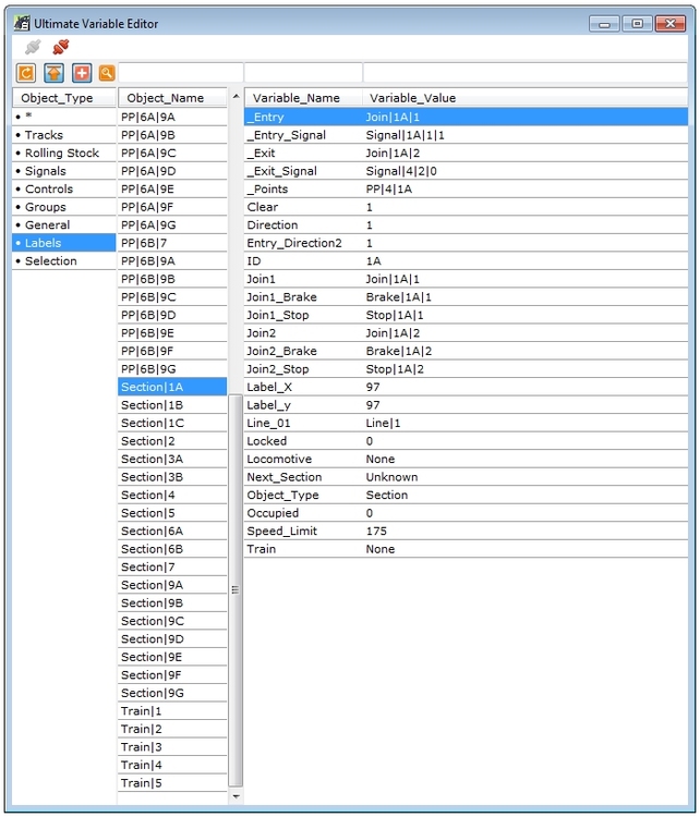

trevor Geschrieben 21. Oktober 2016 Geschrieben 21. Oktober 2016 Hot off the press... I got tired poking around trying to find variables and having to replicate changes in a hundred different spots so I wrote this plug-in.. Features... 1. Structured display of objects types / names and variables. 2. Complex search functionality including use of " * " wild cards 3. Copy and paste variables. 4. Direct edit of Object names, Variable names and Variable Values. 5. Checking for duplicate and bad names and values. 6. Object name changing automatically fixes any variable references to those names. 7. Bulk value or variable-name changes. 8. Select, delete, or change visibility of objects. 9. Show or hide objects that have no variables attached 10. Window can be selected to be always on top or not. Just run the exe or load it into MBS as a plug in... Have fun.. let me know here it you find any problems. --------------------------- NOTE 1: Edits made through the plug-in interface are not automatically registered as changes within MBS itself. Therefore, there is no undo functionality. Further, YOU WILL NOT be prompted to save changes to your MBS design when you close it unless you make other changes directly within MBS itself. Best practice is therefore... a.) Save your current design b.) Make changes using this tool, c.) Test your layout, d.) IF everything is working as expected, save your design. OR e.) IF NOT... re-open your design to recover your last saved state.NOTE 2: Unfortunately, at present, the plug-in interface only supports named objects. You will NOT be able to correctly edit objects with duplicate names. NOTE 3: Object name changes and or variable name changes will NOT be reflected in indirect or custom references in your event manager code. -------------------------------------------------- DISCLAIMER --------------------------------------------- Use at your own risk. Although tested, there is no guarantee or warranty associated with this plug-in. The author is not responsible for ANY damages or loss off data resulting from the use of this tool. MBS_Variable_Editor.zip

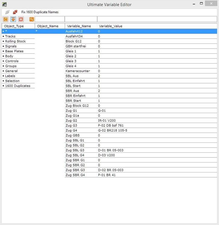

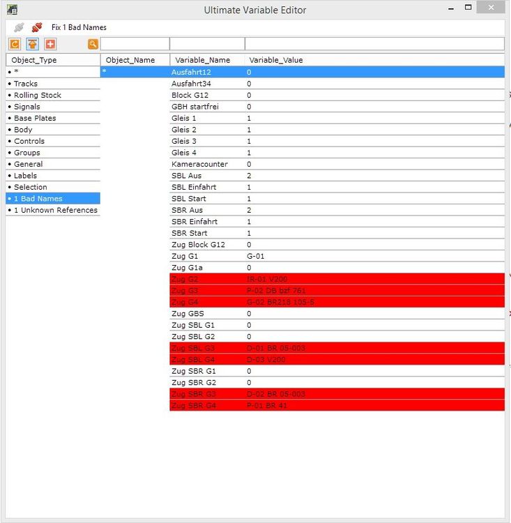

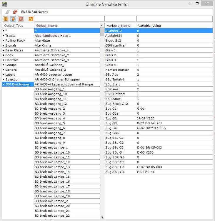

EASY Geschrieben 21. Oktober 2016 Geschrieben 21. Oktober 2016 Hi trevor, ... good idea ... i tested your plugin with the MBS project "Gablerspitzbergbahn" and i got some questions: What is the condition for a "Bad Name" (name with blank seems to be one condition...) and...???? When i start the plugin, then i get this: ... as you can see there are 1600 "Duplicates"... ... so i fixed then... ...then i get 888 "Bad Names"... i fixed them... ... there is still one "Bad Name" and i can't fix this name... ... but now i got 1 "Unknown References" (... is the reference the name which can not be fixed?) or what does "Unknown References" mean? When i try the plugin with the MBS project "Gotthard Nordrampe" then 9493 "Duplicate Names" will be found. If i fix them it will take a long time (several minutes) to fix the names. I do not know if you do... but in this case (rename objects) using a "commandgroup" in the programm should be much faster... EASY
trevor Geschrieben 26. Oktober 2016 Autor Geschrieben 26. Oktober 2016 Yes, I kind of wish I had left that menu item out. Fixing duplicates is only really needed if you have multiple objects with the same name that have variables attached. You could have a million trees with the same name so it would be a pain to sequence through them all and pointless since I can't imagine why ANYONE would add a variable to a tree.. LOL However, I will look at using my new command group handler for that, though I am not sure it would help much since changing an objects name causes MBS to do quite a bit of work to fix up any event handler references. OK so bad names are anything with a space, period, semi-colon or left or right brackets.. for obvious reasons... Bad references can be misleading. For the purpose of the editor I assumed that most text variables would be used to "point-at" some other object. Indeed I was using them for that purpose a lot. As such, the editor will highlight text fields that do not have an object with that name on the layout. If you are using the variable for some OTHER textual meaning you can safely ignore the warnings. I found it irritating that things did not run right because I had some typo like Signal = Singal_42 somewhere....and had to go hunt for it... hence the feature. BTW... if you change the name of objects referenced in variables the editor will also update the variable references.

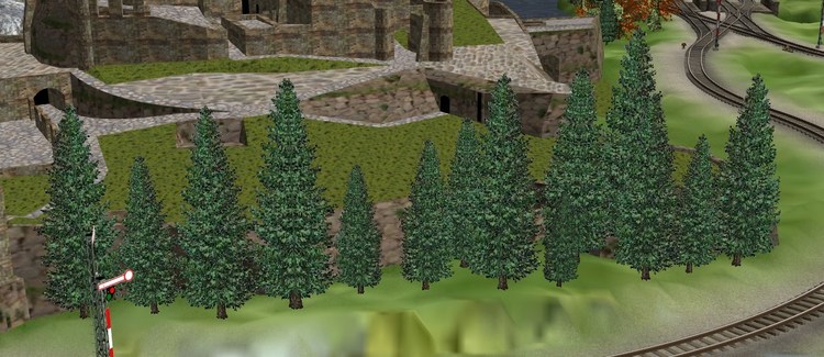

trevor Geschrieben 6. Dezember 2016 Autor Geschrieben 6. Dezember 2016 New edition : Adds two new picks to the tools menu to let you randomize the shrubbery. Random Rotate Selection In Z... and Random Scale Selected Objects... NOTE 1 : SELECTED means "Object Selected in the Variable Editor....", not in your layout, though you can select first from the tool if you want to. NOTE 2 : It is assumed you will select greenery which have their origin at the bottom of the tree or bush. Scaling other object that have centered origins will cause them to no longer rest be on their current object. NOTE 3 : Random scaling will change the objects current scale anywhere from 0.5 to 1.5 times it's current scale. NOTE 4 : As with all plug-ins... unique object names are required. As usual... remember to save your layout first, run the tool, and check things are the way you want, then save again so you don't lose the changes. Enjoy... T MBS_Variable_Editor_20161206_1308.zip
