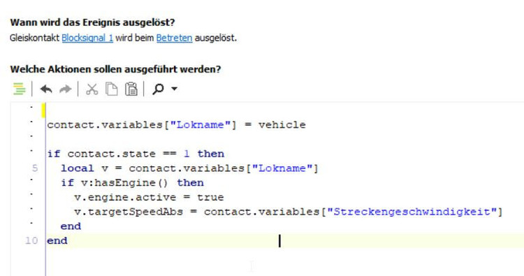

Gleiskontakt Blocksignal 1 werd beim betreten ausgelöst
The event says : the track contact from the corresponding signal is triggered. And that's a track contact not a signal.
If you do not agree : you can easily give variables to a Signal. Try to do that with a track contact associated with that signal. Impossible not ?Really no offence, but when reading some forum topics, there is a confusion what is the signal, and what is that's signals track contact.
The two are not the same at all.

Hello Thomas,
Very pleased with your reaction.
Very useful , we are coming to the point.
v.targetspeedabs = contact.variables["StreckenGeschwindigkeid"]
I have the English version of 3D Studio, and mean that StreckenGeschwindigkeid indeed is set by the signal.
But is it a own made variable set in the signal, that's where I'm looking for.
But many thanks,
Kind regards,
Herman

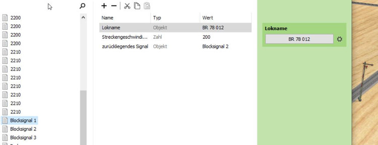

Hello Brummi,
We are nearby a solution,
Please give an example how I can make my own variable and put it on the track contact. I can do so on the signal.
If I put it on the SIGNAL, which is possible, should contact.variables["Herman"] work ?
I will try out to test it. Because that's i'm looking for.
Greetings,
Herman
Hello Brummi and Thomas,
Very nice,
You can make variables in the Signal and adress them with ex v.targetSpeed = contact.variables["herman"]
That's even a very interesting solution.
Many thanks,
Kind regards,
Herman
>>> If I put it on the SIGNAL, which is possible, should contact.variables["Herman"] work ?  <<<
Phew, you got it!
