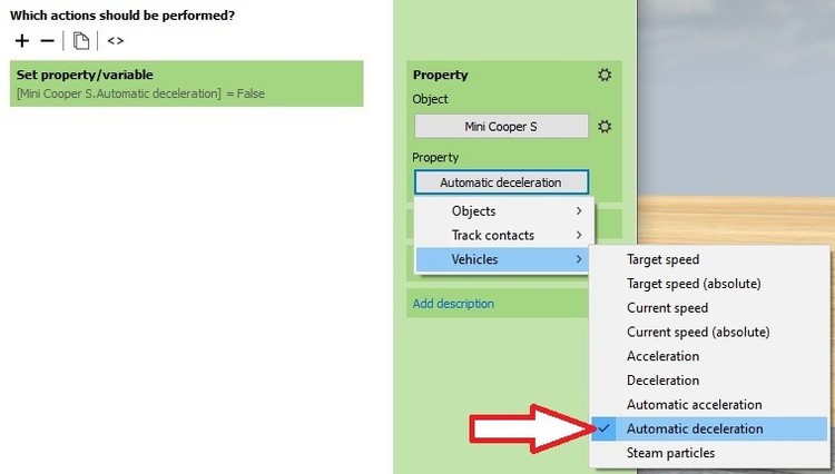

220hotwheels Geschrieben 19. Februar 2021 Geschrieben 19. Februar 2021 Hi everyone Now this might be a daft question but I hope someone out there has a simple solution. In V6 there is the really useful facility as shown in the title to this enquiry. What I would like to know is can this be turned on and off through EM. At the moment if I reverse a car into a garage it stops too soon, before the contact. The same happens if a vehicle reverses up to a wall. I would therefore like to be able to incorporate turning this aspect off when undertaking such operations and then turn it back on as the vehicle leaves the garage. I've looked through the various elements of EM but cannot see anything that points to being able to do this. There is the ability to enable or disable coupling but that is quite different. Cheers Pete
Goetz Geschrieben 19. Februar 2021 Geschrieben 19. Februar 2021 (bearbeitet) vor 8 Minuten schrieb 220hotwheels: can this be turned on and off through EM. Yes. It's a property named "Automatic deceleration": Bearbeitet 19. Februar 2021 von Goetz
