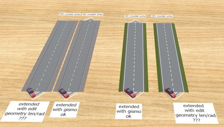

Just to reduce the number of objects ( tracks ) I sometimes edit a track ( rail ) to another length with edit and geometry len/rad.
I did the same with an ordinary street from the catalog, and it works not ( only in the beginning of the street ).
However good news : extends with the Gizmo works fine.
Probably - if not my mistake - a known problem. I just wanted to give the remark here to other members.
Greetings, Herman
note : changing in the bad solution the "model only" to "road"; only makes the middle track available.
TEST street.mbp
These road objects contain multiple parallel tracks.
When you extend one of them by editing it, the others don't follow automatically
The gismo however influences all parts simultaneously
