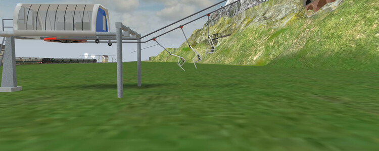

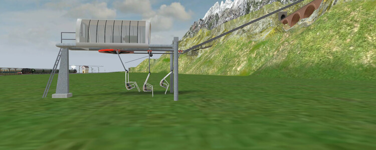

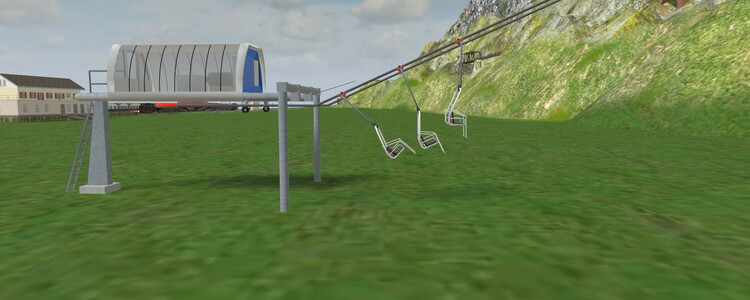

But never mind sagging, just having the cable go up a mountain creates another problem:
The chair in the centre is hanging vertically. in the horizontal station. The one to the right will hang vertically on the way up, and the one at the rear will be vertical on the way down.
When they start going up...
And on the way back down...
Let's hope the safety harness holds on that front chair, hmm?
Again this could be handled by toggling visibility, but why isn't there an animation that can be used to rotate the car to keep it vertical? That would be far more sensible than to have three different cars on the one motor - six if your cable is oriented vertically!
