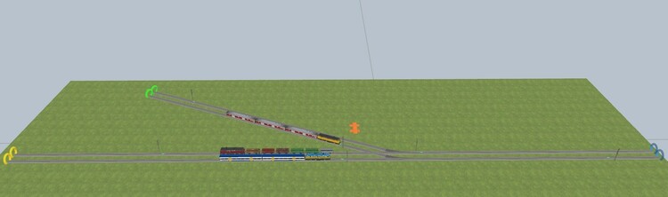

Herman Geschrieben 6. Oktober 2021 Geschrieben 6. Oktober 2021 Hello, I need some help from the route specialists. I started again a test route planning like I had in V6, but want to do it with routes in V7 (of course). I'm already a bit further but I will add the most simple version. F0C50114-E303-47C5-866B-AAD916A25EEC ( draft ) - blocking is done by activating the previous route. ( no problem with that ) - as in my V6, the route planning is done by a track contact before the route, it looks wich route to activate if a vehicle is there. As you can see, it seems to work nice as long as trains demands for different routes. If a train is following another and asks for the same route ( that is not yet released * ) it does not work. Suggestions to solve it ? * To simulate what I want to demonstrate : stop a train long enough on Route1-2, only let him go if the next train is before Form Signal 01 Kind regards, and thanks for looking at it. Herman

Herman Geschrieben 6. Oktober 2021 Autor Geschrieben 6. Oktober 2021 Hello Thomas, thank you, I will certainly look at it this afternoon. In the meanwhile : Further testing gave me a solution. I want to share it. But it is not yet Eureka. And I do no not like it. If trains demands different routes it works. So I made an identical second route Route1-2bis. From Form Signal 01 to Form Signal2. The first train activates Route1-2, the second Route1-2bis. Silly, but it works. Thanks, kind regards, Herman
Herman Geschrieben 6. Oktober 2021 Autor Geschrieben 6. Oktober 2021 2 hours ago, HaNNoveraNer said: https://community.3d-modellbahn.de/forums/topic/6653-fahrstraßen-reaktivierung-geht-verloren/?tab=comments#comment-86410 Hello @HaNNoveraNer, thank you for remembering me to this link. I read it before, but I'm sometimes distracted and forget things. Anyway, the solution of @michellombart does the job. Now only waiting when Neo implements it in the studio. A big thanks to both of you ! Regards Herman.
