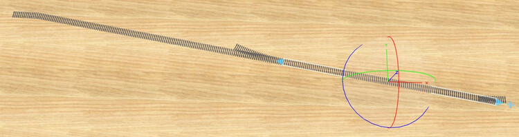

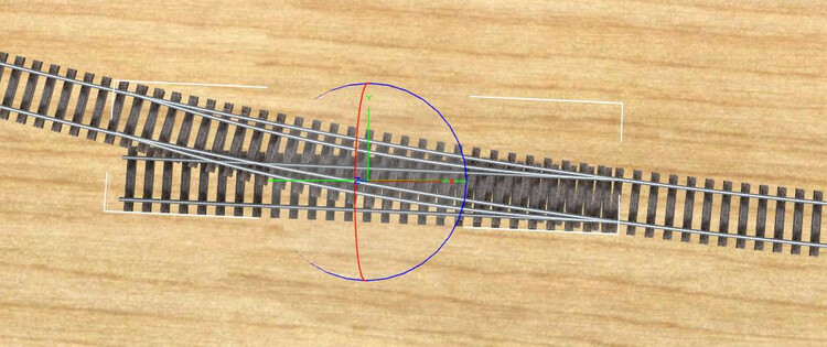

I've not figured out how to do those fancy videos yet, so I'm afraid yu'll have to make do with stills. (I'll get there, it's just finding the time).
Capture.thumb.JPG.8f73b70d106d1ffdb0dadfb7fdc28691.JPGCapture.JPGCapture.thumb.JPG.c5b7abc3325a94cf69eb0d2e86013078.JPGCapture.thumb.JPG.86082a3a04acaa60e9775b537dedef77.JPG
Goodbye smooth curve, hello wiggles!

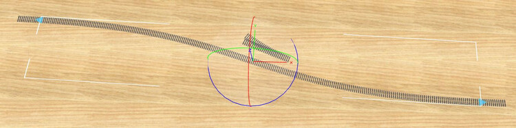

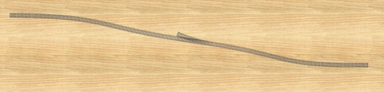

The only way to do it is to position the turnout over the track, carefully, first. Bur what if I'm trying to do some "clever" engineering and create my own turnout with unique track geometry? (And yes, I've managed to do this, it's an interesting exercise in "getting it right!")
Suppose I want to put a turnout on this curve (below)? The flexible track length is already in place, but I've decided I want a siding, loop, or branch connection, and for "Reasons" it has to go Right There!
As you can see, the existing turnout doesn't align with the track and if used will change the shape of the curve, meaning adjustments to scenery, catenary. ballast, landscape, roads... Far easier to be able to cut that piece of track out, and change the cut length into the turn out by adding a route and switch positions...
I'm thinking maybe this could be achieved by adding a "Keep Length" option to the "Follow Path" function? Otherwise it is almost impossible to shorten a length of flexible track and keep the geometry the same.

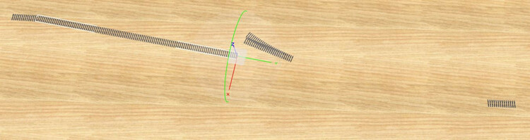

Anyway, here's what I think would work:
Have a "Keep Length" option on the "follow path" tool. So  I put three lengths of track, two long and one the length of the turnout or crossing. And I set them to follow the path of the flexed track length, each in it's own place, keeping the lengths the same.
I then delete the existing length of track, and add the route (and switch positions as necessary) to the short length in the middle.

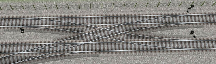

Remember a long time ago I asked about doing a scissor crossing, because the vehicles were doing really weird things? The advice I got at the time (V5 I think) was to shorten two of the points and put a short length of straight track in there.
Well at V7, that doesn't work. The track in the middle there is actually a diamond crossing. edited painstakingly to get the geometry correct, a tenth of a millimetre and tenth of a degree at a time!
It has to be that way. If you just cross to pieces of track over each other, the routes don't recognise each other and the trains do a wonderful job of passing through!
A single diamond in the middle like that gets locked by one of the two routes that use it and the other goes into wait mode!
