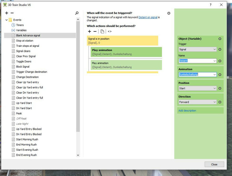

At V6, the following works fine. (It's in my published "Valley Road" layout if you want to see it).

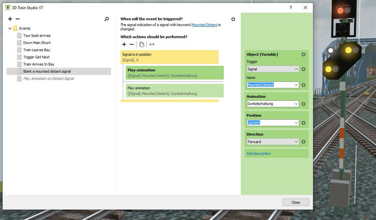

However with the same event on V7:

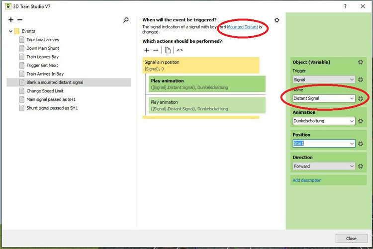

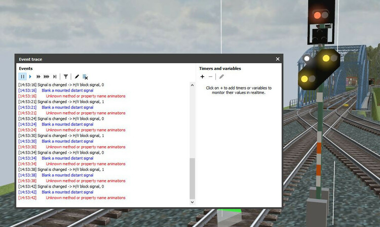

I get this:
And the signal obstinately remains lit!
It worked at V6, it doesn't work at V7.
Okay, forget that.
I spotted the error. It works just fine...

I just needed to put the name of the correct extended variable in. If you look closely you'll see that the name of the variable on the signal is the same as the name of the keyword . Which is not what I had set up.
This works:
Previously it was trying to find the animation on a Keyword!
