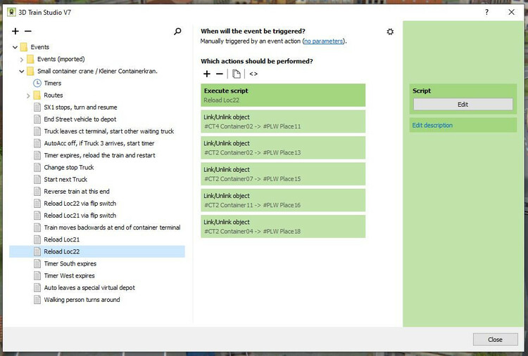

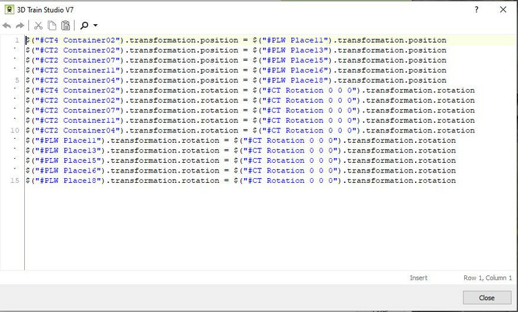

simonjackson1964 Geschrieben 21. Dezember 2021 Geschrieben 21. Dezember 2021 I was browsing the other day and came across this: @Herman A very nice little layout. But how do you get the containers off the trucks and back onto the trains? This is one of the two events that does the job: An I figured out that the script at the start is what moves the containers. But the script... Might as well be in Arabic or Ancient Sumerian... I would love a quick tutorial on this? I can see it being so useful for cargoes of all types, or even wagons that need to be reset to their initial configuration after being shunted. Thanks Simon

Herman Geschrieben 22. Dezember 2021 Geschrieben 22. Dezember 2021 (bearbeitet) 18 hours ago, simonjackson1964 said: I would love a quick tutorial on this? Hello, @simonjackson1964 . I will try to make something here. Thanks for your reaction ! I will try to react very soon. 17 hours ago, Little said: Very good job Hello @Little Thank you very much. But much of the EV and Lua script concerning the routes can much, much shorter with my traject planning (just published). But it was not ready then. ( too much learning new V7 features, and still busy to understand a lot. Kind regards, H Bearbeitet 22. Dezember 2021 von Herman type mistake
Herman Geschrieben 22. Dezember 2021 Geschrieben 22. Dezember 2021 (bearbeitet) Hello @simonjackson1964, "Might as well be in Arabic or Ancient Sumerian..." or Schwäbisch , I hope not after this demo. First I wanted to make something in "Word" and put the .pdf here. But why not demonstrate in a layout ? I put an explanation in each script. Hopefully you have something on this demo ? Transformations.mbp Kind regards, Herman (BE) Bearbeitet 22. Dezember 2021 von Herman corrected a little error in the mbp
simonjackson1964 Geschrieben 23. Dezember 2021 Autor Geschrieben 23. Dezember 2021 @Herman Wow, that is really useful, thank you. I think this should be added to the Tutorials section! I've saved a copy to my database, so I can reference it when I need to. Thanks again. Simon
