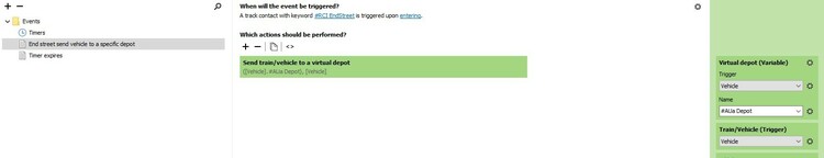

Hello, still testing and yet the "Bösewicht" is still here.
If I send a car in with an empty name of the depot to come out I do not get that error message but this one.
With an incorrect object name the next.
Then the vehicle does not even go to the depot. In my case it goes to the depot, and mostly comes out correct. But sometimes we get the error.

Hello @Neodevelopers, members, Goetz,
For the moment I stop searching.  There are only 4 cars running, and I triple checked their variable. The layout where the error occurs is this one :
5E7583EB-A086-47F5-891C-5172D0FB9BDE ( draft ).
It is a starting layout with a lot of tracks and streets that demonstrates a specific crosspoint in my neighbourhood.  But the code is minimal.
Normally I get this
Sometimes but far not always :( the error haunts. So I cannot reproduce it in a very short time. However it appears frequently, and with different cars.
You can notice the error  outside the analyser because that depot has a vehicle in it, and it should release it immediately. ( below the base plate )
Greetings, Herman
Bearbeitet von Herman
