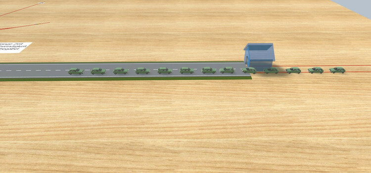

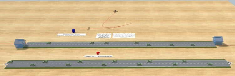

Hello fellow members, I made this little demo how depots can disturb some links. I was very unhappy because I saw their was a problem, but could not isolate it. Until now.
In fact, when isolated ( without depots ) it works fine. In a post from @opax ; @Goetz and @prinz mentioned a depot problem with some jerking. Thank you.
See for yourself : let it run at high speed, without the depots, and then with depots....

Hello Herman,
What happens is that cars leave the depot at the wrong side (rear side).
Is that the problem you mentioned?
Regards, Wolfgang
Hello Wolfgang. No I see it now. The problem is that the forklift does not hold the wood at the correct position. The problem was already there before I connected with the virtual red tracks. That last thing was only done to let the cars run further when the depots where out.  Those extra turn in the virtual tracks may cause the other problem. I will look at it.
Thanks for the reaction.  Herman

Hello members, I saw the problem Prinz mentioned. The depots let the car sometimes out on the wrong side.
Normally I do not connect a track in the back of a depot. That might caused that the cars are going backwards. My fault probably.
Please concentrate on the Lift Fork.

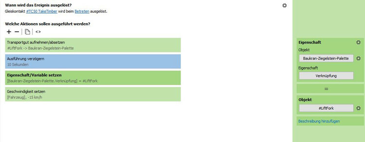

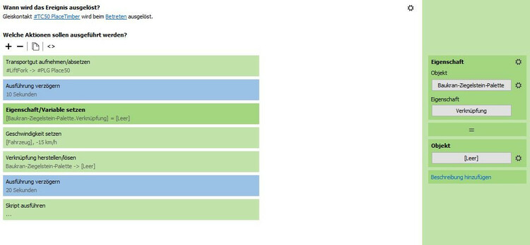

Hello Herman,
Also the crane function should connect the palet to the lift fork try to set the link manually (and release the link). It looks if it now works fine:
Best regards, Wolfgang
Hello @prinz,  I will look at it tomorrow an test it out. Stays the fact that my solution works fine exept when the depots are working. Strange not ?
 Hello @prinz thank you very, very much for this solution(y)(y). If we set the extra link when taking the pallet, it is ok as you said, even with the depots working.
When putting the pallet, your second EV, has no need to release that link. ( ??? ) The link remains, but the liftfork does not take the pallet away at the end. ( ??? )

Hello @prinz ,  I just reworked the liftfork handling in my layout 350FCE74-C47E-47BE-9235-F119DF06ABEB . There are still hiccups due to the depots, but now the wood stays for a very long time ( maybe forever ;) ? ) with the liftfork. ( So I could remove all the special reset contacts, they are not needed anymore. ) Thanks again.
