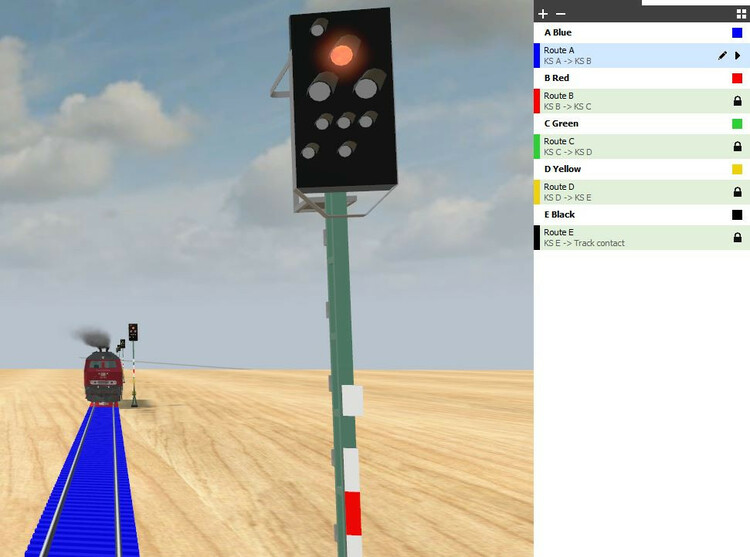

Hi Hermam

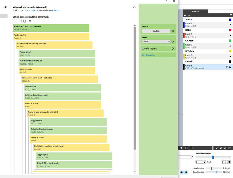

I have used "If route is free and can be activated" when dealing with KS type signals. The KS Multi-section signal shows a different aspect if  this block and the next block are both free than if only this block is free.
So if I have a signal at the start of Route A and route A ends at the signal that is the start of Route B, I want to activate route A to let my train in, and if route B is free and can be activated I set the signal to KS1, if it is not I set the signal to KS2. - I can also use the same function to activate Route B, and check if route C is free and can be activated, thus cascading the green light up the line.
Quickly created example:
The event can be made more efficient by the use of a route keyword and a variable holding the next route on each route, and the event "When a route is activated". but the above is "quick and dirty".

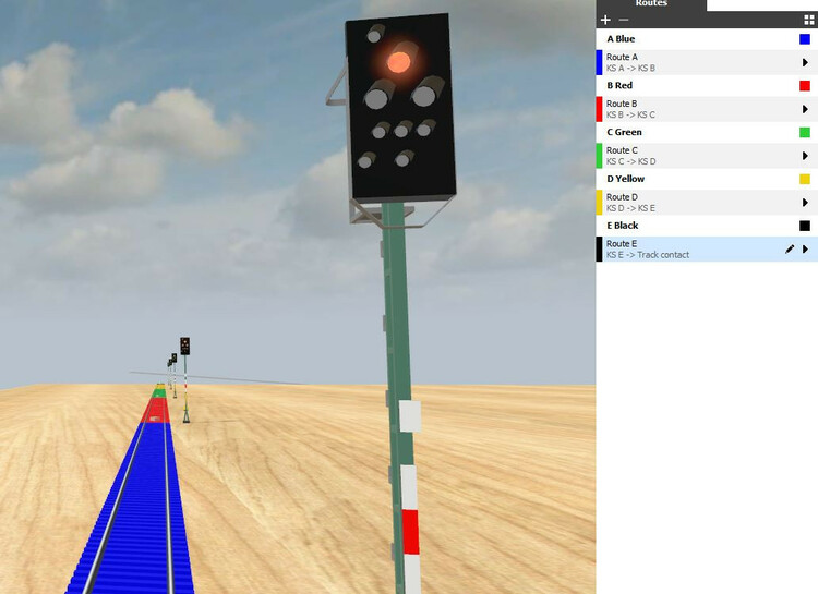

All signals are red - then a train approaches.

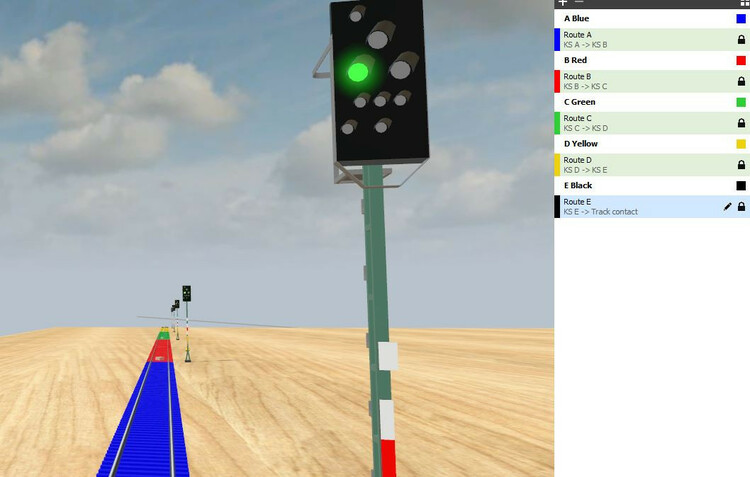

All Signals are green except the entry to E which is yellow.
And the train - well a loco in this case... goes past.
