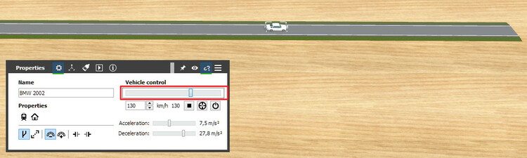

Hello everybody,
I noticed a strange effect, so I isolated it to a fresh, empty layout without any ev or code. Start the auto with say 40 km/h. At the end of the streets he will stop.
If you give after the stop several clicks  ( picture ) to let him return, it jumps back to 0. Just a little patience, click again and it works.
So not a real problem. An explanation of the phenomenon ?  ( V7 english version here ) Do you have it too ? Maybe already signaled by others ?

Hello @Goetz, maybe you misunderstood me. It comes on with 40 km/h ( or whatever ) and it is normal that it stops, it is supposed to do that.
Of course if I click to  give it again a positive speed it will always jump to 0 because of the end.
But I want to click so that it goes now with -40 km/u. ( backwards ) ( I thougt the point of my red arrow was enough to show that, sorry it was not )
Why does it first jump to 0 several times ( if we do not wait some seconds )
Because if you wait a little, as I said, no problem at all.  ( also on single roads , on tracks, with locomotives )

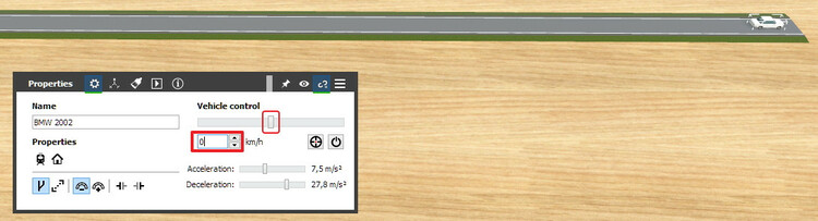

Thank you Götz, missed your second answer. I understand the reason. Still strange that if you manually move the slider ( not clicking ) the same effect.
And if you wait a ( very ) little time all works normal.

As long as the focus is at this control...
... it will not change its value when the car stop at the end of the street...
... so you have to click severel times to change to a negative value...
When you click on an other control (set the focus to an other control) it will change its value to 0

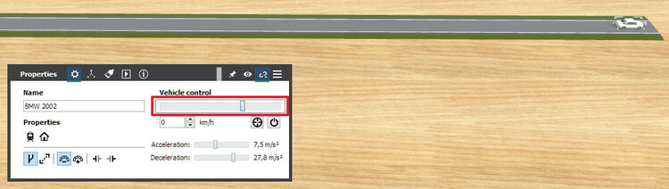

Thank you @Easy. With higher speeds I shoud have noticed that. But I understand it now.
And when not clicking but manual moving the slider, we have to move it much further.
