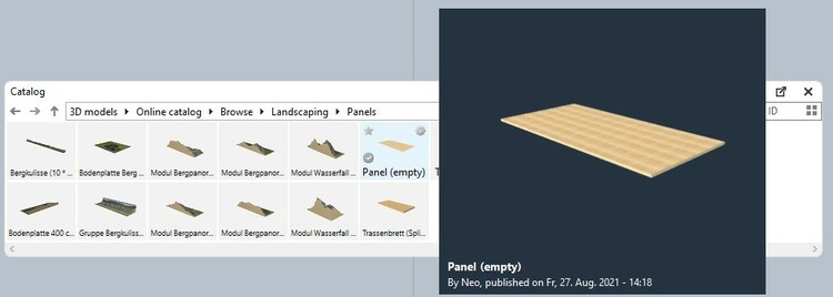

Where do I find a fresh base board in the catalogue I think that's the best way forward.

vor einer Stunde schrieb Eric Lord:
It's in the "landscaping" category under "panels":
I assume that if I do this method then the grd will come back in Technical mode and the stock wooden in both 3d and 2d modes
Indeed that is what will happen.
