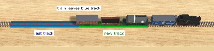

hmclay Geschrieben 6. August Geschrieben 6. August When entering a track I'm using Iteration to check the engines KEYWORD ... depending on response, I trigger a Turnout position. Using trigger as the Track/Contact to analyze ... LAST or NEW track appears as options. Using this I seem to get incosistant results, so I have started just using the Object option and specify the same track that started the event. Need explanation of LAST vs NEW Track usage please.
Goetz Geschrieben 6. August Geschrieben 6. August (bearbeitet) hello hmclay, case 1: In the event that a train enters a track, the rear end of the train is probably neither on the new, nor the last track piece case 2: In the event that a train leaves a track, the front end (i.e. the engine) is probably neither on the last, nor the new track My assumption is that this is the cause of your confusion. Kind regards Goetz Bearbeitet 6. August von Goetz labels improved

hmclay Geschrieben 6. August Autor Geschrieben 6. August (bearbeitet) Thanks to all for the info .... I'mjust now starting to probe the use of extended variables. Goetz sir, guess I overlooked the use of extended variable you pointed out, and how to use it. I get really confused in all the "options" and their usage of when and where. simonjackson196 ... thanks also for your input ... never thought of using a contact keyword. There is a lot of capability in this program ... consequently a lot to learn. In the heat of battle trying to come up with a strategy with seemingly many choices to chose from ... one can become overwhelmed. Thanks much for your insight ! But I'm still unclear about Last vs New ... what would "Last" be used for ... the previous track that the train just vacated ? I presume NEW is the track just encountered ! Your explanation is helpful ... will need to experiment how and when to use LAST vs NEW Bearbeitet 6. August von hmclay Miss the First post of Goetz
Phrontistes Geschrieben 6. August Geschrieben 6. August vor 2 Stunden schrieb hmclay: But I'm still unclear about Last vs New ... what would "Last" be used for ... the previous track that the train just vacated ? I presume NEW is the track just encountered ! Maybe this example will help you to further understand. Last vs new track.mbp vor 5 Stunden schrieb simonjackson1964: May I suggest using track contacts? These have "enter", "centre" and "leave" triggers, and can be located wherever you need them. I agree with the suggestion. Point-shaped track contacts are easier to handle than tracks that have a certain length.
