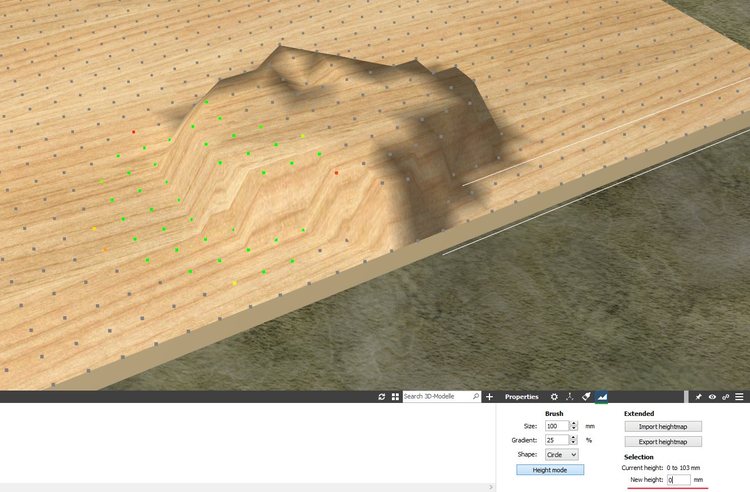

Been playing around with this for a couple of weeks now and just got found the hill / mountain creator!  My problem is trying to get a near vertical face so as to accommodate a tunnel without it leaving gaps behind it or having part of the hill overlapping the track? Also how do i revert the modified section back to flat again without using the undo function?  I have tried changing the settings (circle,square, horizontal, vertical) but this seem to have little effect if any.
Any help would be greatly appreciated

an exact vertical face is not possible, because the studio always interpolates the heights between the grid points. You can increase the grid resolution to get a finer landscape (click the edit button in the properties window).
To reset a section to a common height, just select the appropriate height points and enter a new height (see attached image).
