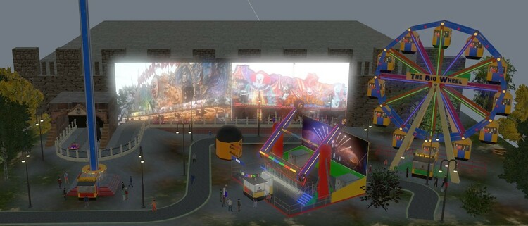

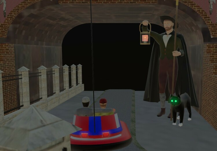

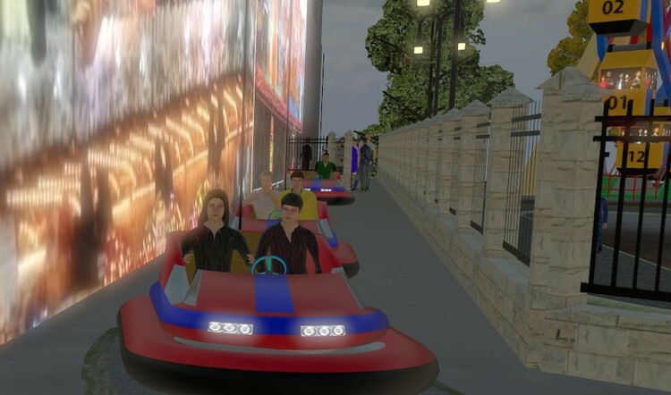

    Hello, Thanks to the idea of "Model Railroad Fun", wich I want to thank, I made this layout. Some Pictures : The layout is operational, and with me at home it's even finished. But next to models from the catalog, I used for the fronts and for 10 ghosts inside a primitive layer and put the texture over it from images of the internet. Due to probably copy rights I do not distribute the pictures. But if someone wants to extend it for home use, there is enough creepy to find on the internet. That's the reason I published the layout in the category "Layouts to extend". CC8F11E9-311E-4F24-8C76-2029AF4A7381 Kind regards, an have a nice day, Herman

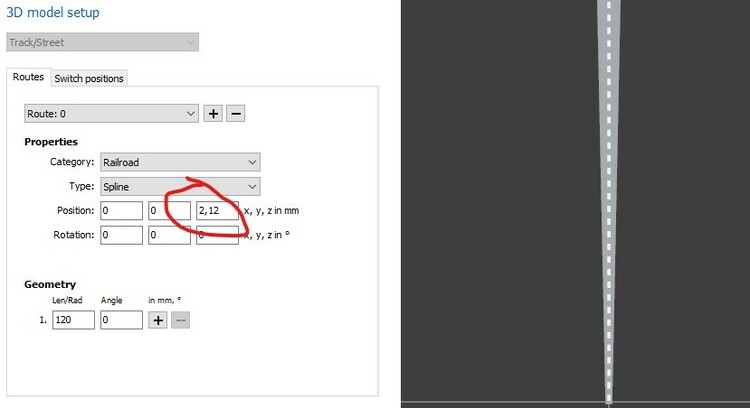

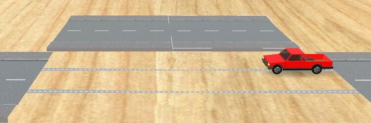

  6. Hello, If forgot to mention : I used Edit and @Henry's idea to put the ramp at z =2,12 before connecting. Kind regards to all the readers, Herman
  7. Hello @Goetz, Thanks for this solution ! This does the job indeed. I took the ramp as Goetz said. And with the gizmo it's easy to adjust the z from the ramps just to the connecting points. Just personal remarks. My fear becomes true, both types of streets are not 100% compatible. Probably due to historical growth in previous versions ? Not that it bothers me, but there is still a small gap between the two kinds of streets. And putting the lower streets a 0,25 mm higher that can hide it, but then the sidewalk does not match anymore. Special thanks to @Henry for his topic to use virtual tracks in the special streets without routes like that for a bus stop etc. I wanted to use the benefits of both worlds. ( streets with and without routes) Thank you Goetz ! Kind regards, Herman

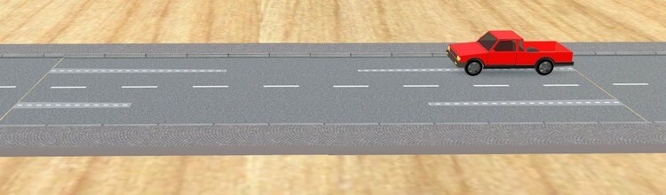

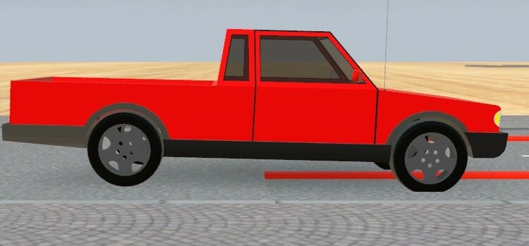

  8. Hello, please some help. I want to combine streets ( with routes in it ) and those without by the use of virtual tracks. But even in the most simple connection there is a bump down. ( my best my best attempt for the virual routes is now z=1,99, at 2 the routes in the street and the virtual routes do not match any more). What am I doing wrong ? Is a smooth connection possible in this case ? Greetings, Herman
