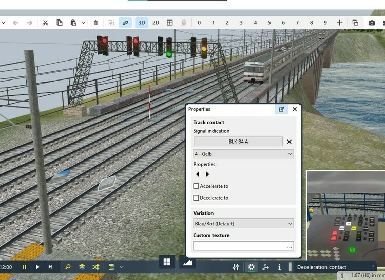

  5. I appreciate the insight Goetz & simonjackson1964 , My main question has been answered -- I just wanted to see if it was a common or known issue, now that I know that it's not then I will work to see if it is the code causing issues.
  6. The main reason for the traffic signals is just that I didn't like any of the available rail signals, and found it easier to customize everything this way (They are placeholders while I figure out how to properly model). I'm curious what code could be affecting this, as far as I know there's no Lua script that can alter the contact properties.
