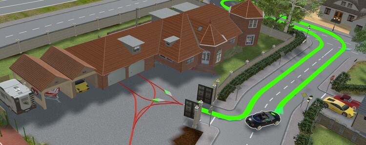

220hotwheels Geschrieben Freitag um 11:06 Uhr Geschrieben Freitag um 11:06 Uhr Hi to all my fellow members I wonder if anyone can give me a valid reason why the vehicle exiting onto this junction will not follow the route designated for said vehicle but simply takes the junction route to the opposite carriageway. Clearly I can solve this issue buy constructing my own junction but should this be necessary? Kind regards Pete

220hotwheels Geschrieben vor 20 Stunden Autor Geschrieben vor 20 Stunden 2 hours ago, gmd said: Hi Pete, You didn't get an answer yet, and to be honest, I do not quite understand what you are actually asking ? The picture does not help me either. Maybe you can elaborate a bit and you may get some answers. Regards gmd Hi gmd Typical of me, I know what I am trying to say but don't explain it properly for others to understand. Basically the layout that I am working on is designed with right hand drive vehicles. Setting the route for all thus far has been no problem. However I now have to set the route for a Bentley Cabrio to leave the owners property and head into town to visit a friend in her apartment. So far so good. The junction into the property is a standard single lane junction as per the initial screenshot. The issue that I had was that despite setting the route to depart through the gates, do a quick round trip (for experimental purposes only) and then return to the property. However I could not get the Bentley to follow the route set, it simply departed heading across the road and onto the opposite side as if it were a left hand drive vehicle. Since posting my question Herman has come back to me with a solution which works fine, see attached small demo layout, but in trying to apply this to my actual layout it is not working as I had hoped. In fact the Bentley seems to have a mind of it's own and will follow the set route for so long and then it simply goes it's own sweet way and the set route is lost. Other vehicles follow a similar route without issue. To try to explain the problem I have made a short demo. A) uses Herman's method and works perfectly with no rear twitch when arriving back. B) Is the initial standard junction that has given me so many headaches. C) Is my solution to the problem with B but it produces rear end twitch on return. D) Is a modification of C with much reduced rear end twitch. The solution would seem to be to follow the advice offered by Herman and to split the route into sections. My attempt at this has so far been a bit unpredictable which would suggest that I am doing something wrong. Having set the routes as A to B, B to C, C to D I find the route disappears once the Bentley enters C to D. It also ignores traffic lights set at the end of B to C. Clearly I have much more work to do in locating the source of the problem. Many thanks for your interest in this issue. Kind regards Pete Test layout single lane junction.mbp

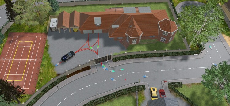

Goetz Geschrieben vor 19 Stunden Geschrieben vor 19 Stunden (bearbeitet) vor 2 Stunden schrieb 220hotwheels: it produces rear end twitch Hello Pete, these twitches happen when no target is assigned. You never assign a target for the return route, leaving it to chance which way the Bentley goes when it comes back. Also, switches and targets don't mix well. I replaced the switch in your virtual track loop with two normal track pieces, assigned a destination for each step of the way and everything runs like clockwork: Test layout single lane junction G.mbp A second variation with fewer (hence the F ) contacts: Test layout single lane junction F.mbp Kind regards Goetz Bearbeitet vor 18 Stunden von Goetz second example added

Goetz Geschrieben vor 17 Stunden Geschrieben vor 17 Stunden vor 3 Minuten schrieb 220hotwheels: I am wondering if it might be prudent to remove the Bentley Cabrio and replace it It has nothing to do with the Bentley in particular (nor with stopping the car at a more realistic position than I did in my lazy layout). We'd love to help you identify the true cause of your predicament. Alas ... without access to your troubled layout, that's a tad difficult. Kind regards Goetz
SualokinK Geschrieben vor 17 Stunden Geschrieben vor 17 Stunden Hi Pete, Here is the E variant again. Now the Bentley drives out of the exit ramp once to the right and once to the left and also stops further into the road. Maybe it will help and, as @Goetz already wrote, it has nothing to do with the Bentley, but depends on the position of the contacts. Because @Goetz has offered his help, I will withdraw. It is the better plant manufacturer. Best regards SualokinK Test layout single lane junction E.mbp

Goetz Geschrieben vor 16 Stunden Geschrieben vor 16 Stunden Hello @220hotwheels, here is one situation which causes the Bentley to lose it's route: When any vehicle enters the contact at the hotel, you assign DC-Low Wood entry gate as the Bentley's new target. But the Bentley is nowhere near this hotel. From it's current location, the target is out of reach for the Bentley. And when you assign an impossible target, the set route is lost. unrelated: The event TC4a-additional crossing control produces an error message and pauses the layout when the event trace window is open. I haven't figured out yet what that error is about. Kind regards Goetz
Herman Geschrieben vor 16 Stunden Geschrieben vor 16 Stunden (bearbeitet) 1 hour ago, 220hotwheels said: quick run through the Bentley failed to stop at the second junction Hello Pete, look at the track contact. When stopping the bentley hits this next track contact. But it is an acceleration contact to 25 km/h , so the Bentley immediately goes on. I placed the second TrCt a bit further. Correction not the case here because the deceleration of your Bently is high enough. The real cause is that you took the wrong name of the TC. See further. Kind regards, Herman Bearbeitet vor 15 Stunden von Herman correction
Goetz Geschrieben vor 16 Stunden Geschrieben vor 16 Stunden The event TC4a-additional crossing control produces an error message, because you attempt to subtract 1 from what is actually a keyword.
Herman Geschrieben vor 15 Stunden Geschrieben vor 15 Stunden (bearbeitet) Hello Pete, 1 hour ago, 220hotwheels said: quick run through the Bentley failed to stop at the second junction There is something about your code to stop the Bentley there. Names! I simplified the code to this, and it works. Try to work with a trigger if every car may stop there for a while. Otherwhise you can use a condition as in the previous junction and explecitely say it must be the Bentley. Can you try something out ? Hope we helped you a bit further. Kind regards, Herman Bearbeitet vor 15 Stunden von Herman typo
220hotwheels Geschrieben vor 15 Stunden Autor Geschrieben vor 15 Stunden 54 minutes ago, Herman said: Hello Pete, look at the track contact. When stopping the bentley hits this next track contact. But it is an acceleration contact to 25 km/h , so the Bentley immediately goes on. I placed the second TrCt a bit further. Correction not the case here because the deceleration of your Bently is high enough. The real cause is that you took the wrong name of the TC. See further. Kind regards, Herman Thanks Herman, yep I found that too by going back over everything. Kind regards Pete 1 hour ago, Goetz said: Hello 220hotwheels, here is one situation which causes the Bentley to lose it's route: When any vehicle enters the contact at the hotel, you assign DC-Low Wood entry gate as the Bentley's new target. But the Bentley is nowhere near this hotel. From it's current location, the target is out of reach for the Bentley. And when you assign an impossible target, the set route is lost. unrelated: The event TC4a-additional crossing control produces an error message and pauses the layout when the event trace window is open. I haven't figured out yet what that error is about. Kind regards Goetz Thank you very much Goetz. That was meant to be the start point for the return of the Bentley to Low Wood but I will remove it for now and rethink at a later date. I am also looking into the event TC4a-additional crossing control. Kind regards Pete
