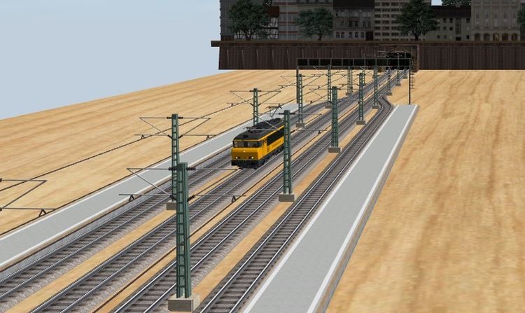

simonjackson1964 Geschrieben 26. Juli 2018 Autor Geschrieben 26. Juli 2018 Okay, thanks. that looks an awful lot easier... I guess with junctions, the best thing is to run one way, then reposition the train at the post before the junction and run it the other way... What about multiple tracks though? I mean obviously with a double track, you just run the catenary down both sides. But what about three or even four tracks...? Prototype, of course... That's the Midland Mainline But this is what I want to electrify... I already discovered that the tunnel mouth and signals are too low, I have my work-around for those already. But basically I need a gantry that will span four tracks and two platforms, that I can hang the contact wires from. Suggestions appreciated? I suppose as an interim I could fit the masts between the tracks...
Andy Geschrieben 26. Juli 2018 Geschrieben 26. Juli 2018 Hi simon, you could combine masttypes. First use the plugin for the standard ones, then remove some and use the wide ones, like here:
simonjackson1964 Geschrieben 26. Juli 2018 Autor Geschrieben 26. Juli 2018 (bearbeitet) That looks better than I came up with.... I was trying to use those before, they're the animated length ones which is really weird! But I hadn't spotted the "connect" feature. I'll give it a go. Ah, but they don't have the "Connect" feature... What I came up with may not be elegant, but it works! Bearbeitet 26. Juli 2018 von simonjackson1964 Add picture
Andy Geschrieben 26. Juli 2018 Geschrieben 26. Juli 2018 Looks even more accurate than my one, but be prepared, there is a work in progress which will give us another system in the future. Just be patient, there will be anything to be done ever in any way - but that's the plan Andy
