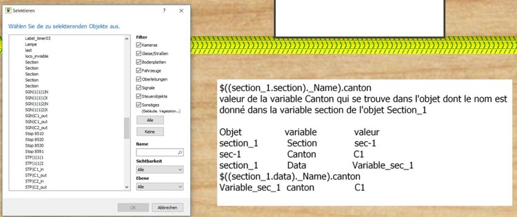

Situation :
I have a track called "section" in which I have the variable "Canton" with the value "section_1"; this value is the name of a variable in the object "itinary".
I have another object called "Itinary" describing the traject for the train; in this object itinary, I have defined the variable "section_1" having the value "section_3" which is the next section.
I need to set the object variable "section.next_section" to the value from the object variable itinary.XX where XX stands for the name found in the variable canton from object "section"
Section.canton = section_1 - (section_1 this is the name of the variable from itinary containing the name of the next section for this section)
Object                 variable                             value
Section                canton                              section_1
itinary                  section_1                          section_3
Event
Train enters track               Section
No conditions
Actions :
  1  set variable A =
$((_Trigger2.data)._Name).canton                                                          ==>  A = section_1 (= name of the variable in itinary)
  2  set variable $((_Trigger2.data)._Name).next_section = $(itinary._Name).????                ==> next section = section_3
                                                       where ???? must be the variable's name which value is contained in the variable A
how to build this action?
Thank you for your help

Hi Andy,
The purpose is to build a common event able to pilot a train through the succeeding sections of the layout, according to an itinary (traject).  This means that each time a decision has to be taken for the next section to reserve, I would find the name of this next section as the value of the object variable called itinary._Trigger2.  But this combination doesn't work!
In addition, I will assign the same name to all tracks acting as section : the name will be section and this object will have a pointer to an external table called "variable_sec_n" (n varying for each section) where all needed data will reside.  This permits to copy this table easier than if the data are part of the track itself.  So, I hope to have only one event to manage all sections in my layout.  But, as Martin Luther King said : " I had a dream..!".
The itinary to be followed by a specific train  is defined as the object variable itinary in the object train.  So, changing the traject for a train becomes very simple.
Have a look to the event "test" in the following layout used for the different tests I'm doing.  The results of this event are displayed in the center of the layout (value of A / B / C).  However, the value of C is currently coded as $((_trigger1._Name).itinéraire).section_1 where I hope to replace section_1 by the content of another variable and that is the current objective I'm trying to reach.
I hope that it is now clarified for you.  Anyway, thank you for your help.
Regards
André

Hi Tom,
This layout is my "laboratory" where I test different thinks.  So, don't be scared if you don't find any logic between the layout and the events.
1. The 5 cubes you discovered are well object containing variables normally attached to a specific track (say section_n) within a block.  The only reason is the following : if those variables were really attached to a track, it becomes impossible to just copy them if the new track is different (straight><curved, long><short,...).  Having independant object solved this problem.
2. The board you discovered there is only a way to remember the syntax.
3. Each block has a track called "section"; their usage is to manage the block mentionning all needed data such as reservation, name, signal, etc...  But, as earlier explained, these object-variables are set into the 5 cubes you discovered and the section track object contains only one variable "section.data", linking that track to its specific cube.  The purpose was to have one and only one event for all "section track", but it seems to be impossible in V4 as discovered earlier in this thema : the variable's name must always be hardcoded and cannot be the value of another variable : VAR1 has the value TRK01 but one may not use $VAR1 as the name of the variable TRK01.  In other words, the syntax $(VARx._Name).$VAR1 is wrong.                                    André
