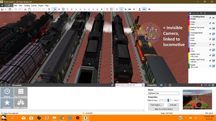

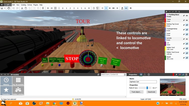

a different method for controlling a locomotive anywhere in a layout.
I place a camera above the loco to show the top and link it to follow the loco
view through the camera atop the loco and controls to drive and stop the loco as well as camera controls

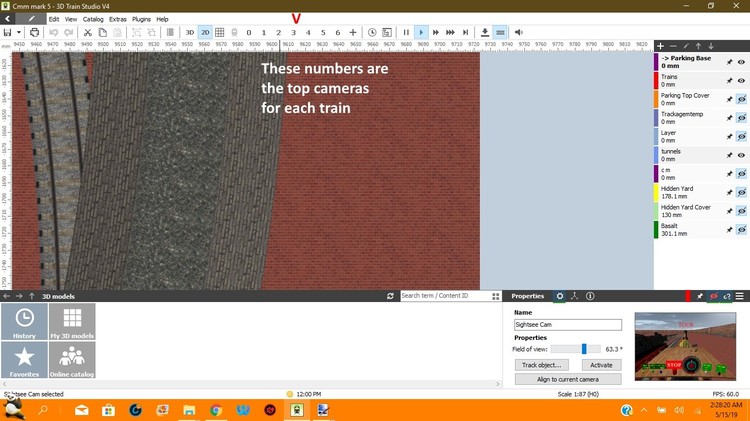

each train in my layout has it's own camera and controls accessed from top bar

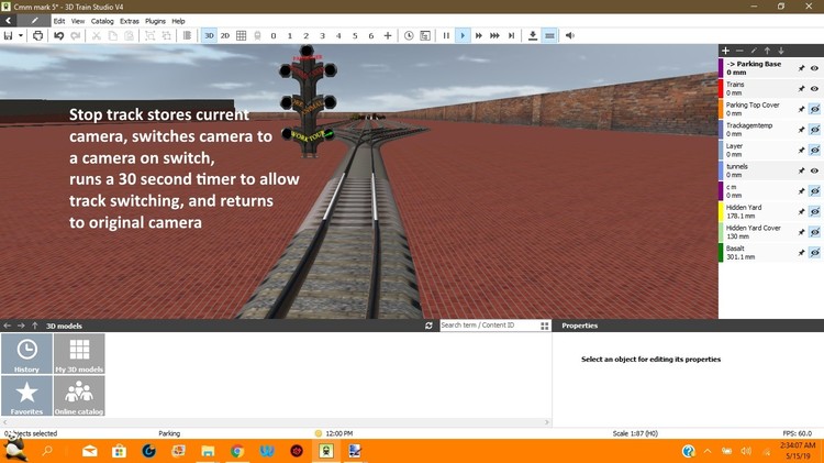

EV switches from moving cameras to stationary cameras as needed and back.
