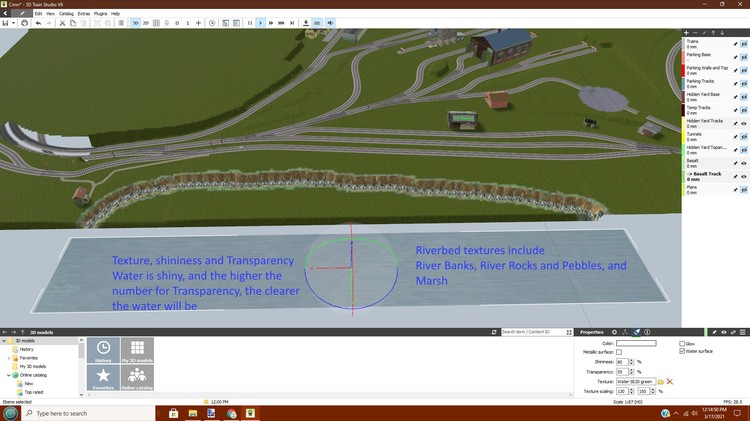

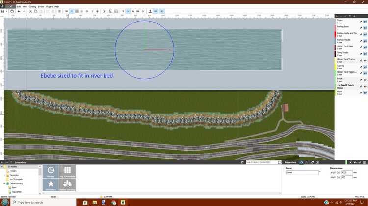

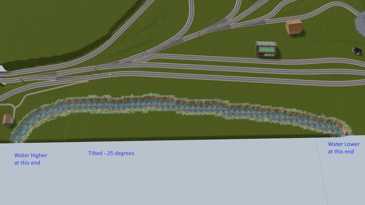

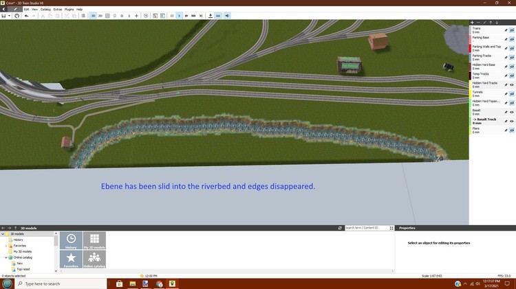

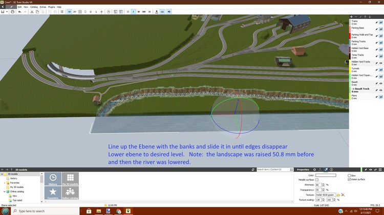

Do you mean like this?
I added an Ebene and textured it with a water texture, made it mostly transparent so that the rocks would show,
lined it up with the edges and lowered the ebene, so the water was below the top.

That's what I did in the video too, Eric
The only reason the water appears to follow the contours is that I did what Curt suggests too:
I made sure the river bed is lower than any other ground. And I lowered the square-shaped water plate enough to hide it under the land.

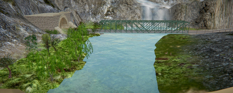

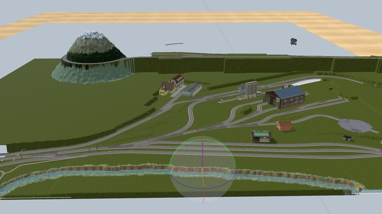

I have done something similar.
This was created in V5 (but still works in V6!)
River.thumb.jpg.6eda2e41296934fedd1dc5fdbfa480a1.jpg2034626722_River2.thumb.jpg.6fd76a15832280b2ae42ebddbf6f60b4.jpg
Worth  note: Where the river meets the end of the baseboard, there's an additional rectangle "Ebene" (to use the word our German hosts use) coloured with the same water texture, and turned through 90° on the Y axis, so it is vertical and in the same plane as the edge of the baseboard, thus giving an end to the water itself

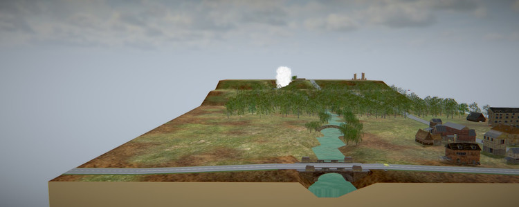

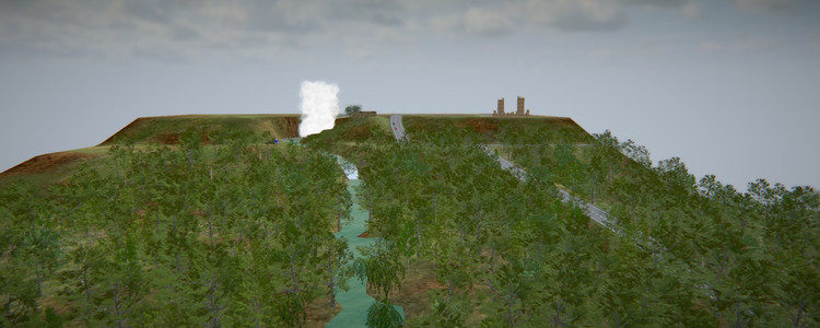

This one is entirely in V6, but is a work in progress. Partly because I need to clear out all the events and start from scratch... The river is quite shallow and the waterfall is fixed on the mountain module

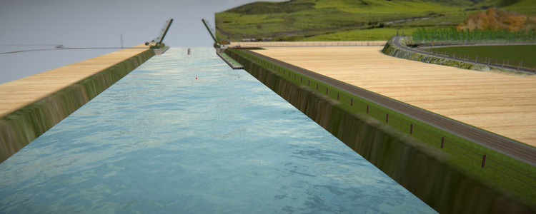

The canal, on the other hand...
1680903132_Canal1.thumb.jpg.c513df9fdc7a10800fded4e4b14b610e.jpg53081585_Canal2.thumb.jpg.24d2adb265febe97d728675ae449a368.jpg

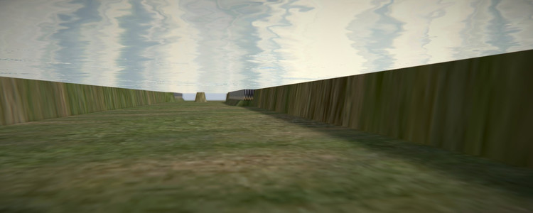

You can go swimming if you want! Same technique as the end-plate, but set the y-rotation to 180. set te x, y and z coordinates to the same as the surface, linked the two together and presto, the water surface as seen from underneath.
