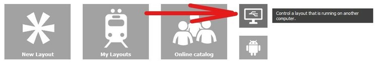

The required menu on the start page is this one and the one below (Android).
But it's targeted at using two devices in one home network, for all I know.

you can connect to other 3D Train Studio instances by using the network control feature (see Goetz's post). But Goetz is right, while this feature technically supports Internet connections, it is currently targeted to local networks. You can still try this feature, just enter the public IP of the computer running the layout and make sure that your network configuration (router, firewall...) supports incoming connections (TCP and UDP ports 31285 and 31286).
A real multiplayer feature is scheduled for one of the next major versions of 3D Train Studio.
