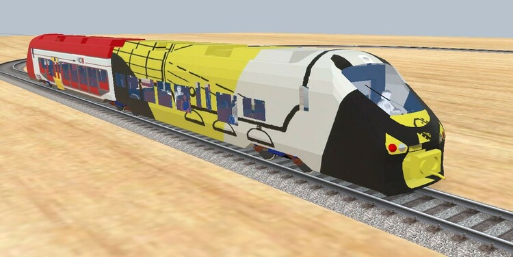

Excellent, Hubert; I've got it working, but a part of the issue has been a misunderstanding on my part. I thought that the Custom textures should show up as a drop-down list, in the same way as the Variant. This is not the case, as I now realize; one simply has to select the file required and the texture is applied. In fact, it seems that, as long as the texture file is '_Custom', the rest is either ignored or not used, and one may select any picture file at all; MBS will apply it to the model. Here's a picture (the cover of a guitar method book; not even multiple of binary ² dimensions, and MBS drapes it over the model.
I found that only the '_Custom' declaration is needed; the others never appear anywhere. I'm surprised, but it's working, so that's a Good Thing. As long as there's a declaration of '_Custom.png', any picture file can be used. I don't know if this is normal, but it works ..!
Excellent, Hubert; I got it working, but part of the problem was a misunderstanding on my part. I thought the custom textures should show up as a drop down list, just like the variant. This is not the case, as I now realize; All you have to do is select the file you want and the texture will be applied. In fact, it seems that as long as the texture file is '_Custom', the rest is either ignored or not used, and one can choose any image file; MBS applies it to the model. Here's a picture (the cover of a guitar textbook; not even a multiple of ² binary dimensions, and MBS drapes it over the model.
I've found that only the '_Custom' declaration is needed; the others do not appear anywhere. I'm surprised, but it works, so that's a good thing. As long as there is a declaration of '_Custom.png', any image file can be used. I don't know if this is normal, but it works ..!

hello @Dad3353 what a good job! I upload the model in the game to see and inside the cockpit we can see the back of the outside texture. I think you can create a cockpit wall or maybe there is an option ;) thanks again and tell me if i can help.

That is not needed and is redundant. If the name of the original texture is already _Custom, then the texture replacement feature gets enabled.

hello Dad3353 what a good job! I upload the model in the game to see and inside the cockpit we can see the back of the outside texture. I think you can create a cockpit wall or maybe there is an option ;) thanks again and tell me if i can help.
If only that were the only issue..! There are many, many 'issues' that I'm trying to resolve, slowly. So slowly, in fact, that I have often forgotten the solution when the same issue occurs, weeks later..! I try to note 'helpful hints' and jottings, but, with advancing years, I even forget that I've already noted the solution before..!
You are right, but the 'back of the outside texture' is a strange effect from not mastering the 'normals' of a mesh yet, and I still struggle to create a 'wrap-around' UV map for applying textures. Consultation of the Internet brings up many helpful information, but just as much redundant, out-of-date or even completely wrong stuff, and I find very little doing the same sort of things. If I wanted to know how to 'unwrap' a monkey's head, I'd be fine, but a locomotive..? Maybe I don't know how to look, after several decades of IT work..!
Patience, young Padawan. I am being assisted by very patient Masters, and am, despite everything, learning and improving (at a snail's pace, but still...). The model I posted to the Catalogue is simply a test piece, to see how to upload to the Catalogue, and will disappear shortly. Don't fret; I'll post a more complete model once I've stabilised my current modifications (merging textures, rationalising file names, creating low-poly passengers and more...), and you'll be able to give your views on those, to help even more. Nearly there, I hope..!
