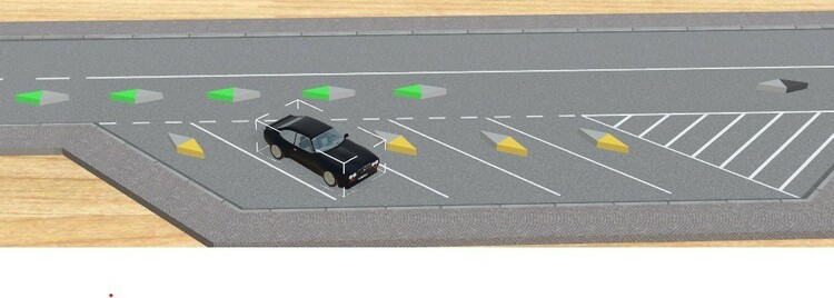

Herman Geschrieben 28. Oktober 2021 Geschrieben 28. Oktober 2021 Hello everybody, Maybe sombody noticed something simular in going from V6 to V7. In V6 I have a working parking spot. It does not work in V7. Problem : when the autos leave the parking spot backwards they turn back into the parking. Why ? They reach the green track contact too soon in V7, in V6 it is fine. Solution : move the green track contacts slightly backwards. Verify that an auto comes to the straight position before touching the green track contact. I did that verifying also in V6, but there the autos reach sooner the straight position. Kind regards, Herman If anyone is interested, here is the V6 version. BC17F424-575F-4535-8910-915943F01111 ( draft )
220hotwheels Geschrieben 29. Oktober 2021 Geschrieben 29. Oktober 2021 On 10/28/2021 at 4:32 PM, Herman said: Hello everybody, Maybe sombody noticed something simular in going from V6 to V7. In V6 I have a working parking spot. It does not work in V7. Problem : when the autos leave the parking spot backwards they turn back into the parking. Why ? They reach the green track contact too soon in V7, in V6 it is fine. Solution : move the green track contacts slightly backwards. Verify that an auto comes to the straight position before touching the green track contact. I did that verifying also in V6, but there the autos reach sooner the straight position. Kind regards, Herman If anyone is interested, here is the V6 version. BC17F424-575F-4535-8910-915943F01111 ( draft ) Hi Herman Only just picked up your post. I am not very good at explaining how things work but might I suggest you take a look at an item I posted earlier "reversing out of a parking bay". I think the answer that you are seeking might well lie in this item with the solution provided by @simonjackson1964with a comment by @Goetz. I now have the problem solved. My next dilemma is roundabout control. At the moment I have just too many very poor drivers who just don't want to give way. But that is a problem for another day. Hope the above helps. Kind regards Pete
Herman Geschrieben 30. Oktober 2021 Autor Geschrieben 30. Oktober 2021 13 hours ago, 220hotwheels said: I suggest you take a look at an item I posted earlier Hello @220hotwheels. Nice that you do remember me on that post. I will read it again, always looking to learn something. Thanks Pete. I had already a solution for the V6 version to work in V7. But yesterday I managed to rework the same project in V7. Without switches in the parking spots, but directly with targets. In my parking spot ( also in V6) the cars will go in and out the parking randomly with respect for the other traffic. The problem for the moment is that if I read to much in the forum, ( and since V7 there are a lot of interesting post here), the layout I'm currently working on, get to few attention. Kind regards, Herman
