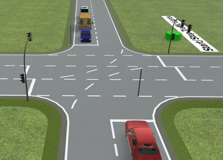

I was testing this layout yesterday evening. It is in the fase finishing touch.
When I opened it this morning, three traffic signals and a lot of track contacts disappeared in the second crossing. ( crossing : a copy of the first via paste from layout )
When looking at the list, they were all there on the layout, and should be visible ?
( In the layout I did not yet gave the copy signals their own names, but because the events are object related, all seems to work )
It still is possible I overlooked something. Please have a look at it. 9AC60BB0-7621-4DF3-BB2F-C942EE0ACF38 as a draft.
Kind regards, Herman
1784628169_crossingsignals21-12-10.jpg.287b0b74537684e98e78c0962ad3f2d8.jpg401093774_crossingsignalN21-12-10.jpg.d497d101601c184955bb755a9dd56cc2.jpg

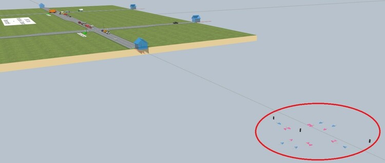

Hello @Herman
This is where all the items went:
As to why they did, I cannot possibly say. I didn't watch you when it occured.
But it looks like "fingertrouble" to me.
Hello @Goetz ,
I did nothing but a save. All this track contacts and signals were on the right place when I saved it. When I opened this morning the layout they were moved....
Also the pole from a signal as you can see.  But thank you at least they are found.
Still strange, because I just mentioned another failure after the save. ( and nothing was running )
Kind regards, HP
Bearbeitet von Herman
And @Goetz , even if they moved to such a strange place, they still did their job as track contact correct. (*)
( I'm now looking at my own layout) How did you make them visible ? Sorry ...  Found them.
Kind regards, and thank you ! Herman
* I mean the cars react correct on the track contacts ( as if before the signal ) even if they are on another place.
