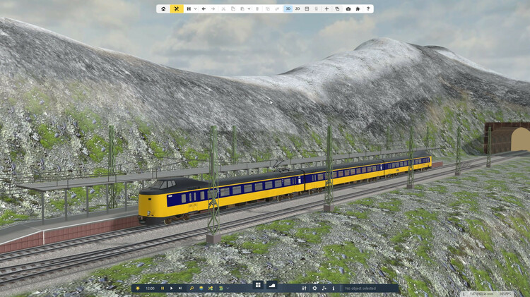

Bas Geschrieben 14. Februar 2023 Autor Teilen Geschrieben 14. Februar 2023 (bearbeitet) I was trying and playing around with the hills a bit. https://images.bas-tech.support/4iia.jpg how does it look to you? The catenary was some struggling too but decently easy. Edit the link didn't show so i posted it as a image now. Bearbeitet 14. Februar 2023 von Bas link didnt embed Link zu diesem Kommentar Auf anderen Seiten teilen More sharing options...
simonjackson1964 Geschrieben 15. Februar 2023 Teilen Geschrieben 15. Februar 2023 So far to good! Link zu diesem Kommentar Auf anderen Seiten teilen More sharing options...
Bas Geschrieben 16. Februar 2023 Autor Teilen Geschrieben 16. Februar 2023 Do I need more distance between every pole for the catenary? Link zu diesem Kommentar Auf anderen Seiten teilen More sharing options...
simonjackson1964 Geschrieben 16. Februar 2023 Teilen Geschrieben 16. Februar 2023 Not necessarily. Obviously the further apart they are, the less items you will have on the layout and the quicker it will load and run, but there's no rule that says the poles have to be a certain distance apart. (Or if there is it doesn't apply to a model...!) On my (WiP) layout of the real Furstenburg (Havel) station (as opposed to the model that is nothing like the real station), I measured the spacing between the masts using the measuring tool on Google Earth. Many of the posts are between 45 and 65 metres apart. The model catenary spline will only extent to just under 40m before the centre "pops up" to demand a new support. Point being if you want a prototypical spacing you will need to do what I did and use two of the tunnel entrance variants end to end. And believe me when I say that is a lot harder than it sounds! So, do whatever you think looks right. The masts will need to be closer together on curves and at junctions/crossovers to keep the pantograph on the wire, but on straight track it really doesn't matter, Link zu diesem Kommentar Auf anderen Seiten teilen More sharing options...
