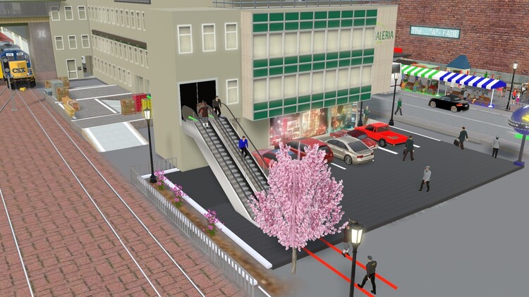

Maybe the layout B6CC6478-3AC5-448A-B553-0B7AF29185C5 by @Eggu will help you if you want to know how to move people. There it is an escalator, which is even more complicated than an elevator.

Maybe the layout B6CC6478-3AC5-448A-B553-0B7AF29185C5 by Eggu will help you if you want to know how to move people. There it is an escalator, which is even more complicated than an elevator.
I'm flabbergasted ..... Hats off to Eggu ... how did you even think and come up with that solution ... and where did the escalator come from ?
Thanks Phrontistes for sharing that !
I've got to include that in my layout !!!!!!!
Included in layout ... first step !
Thanks for the link !

53329B2B-0C12-4255-AB17-65DDF33DF51A (model by @fmkberlin)
