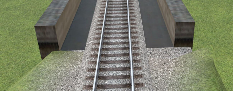

This isn't a problem so much as a solution to one, that I thought I'd share, in case any newer members are having the same trouble and haven't come up with their own way of solving it yet...

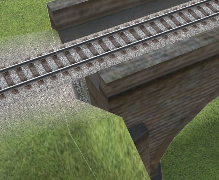

So the problem arises because the baseboard is based around a rectangular grid. Obviously this has to be there, and frankly I'm always amazed at the level of detail the graphics in MBS can display. But the simple fact is that the rectangular grid creates corners And when raising or lowering terrain to create bridges or tunnels, these corners can get in the way.
This is especially the case when creating embankments or cuttings using the ramp tool, and the track is not angled exactly at 0°, 90°, -90° or 180°.

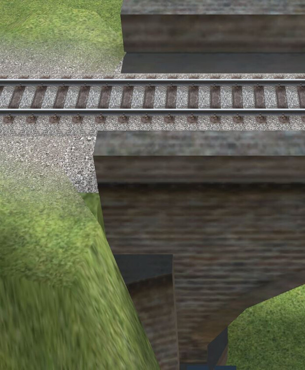

When trying to put a bridge on that track, one can find that the baseboard pokes through the support piers. Move the bridge away or lower the offending bit of terrain so it doesn't, and you end up with gaps...
CaptureA2.JPG.c1e949699c5210386964f89e54ff2b83.JPGCaptureA3.thumb.JPG.ec410fdbfbde1330f4810f2022dc34de.JPG

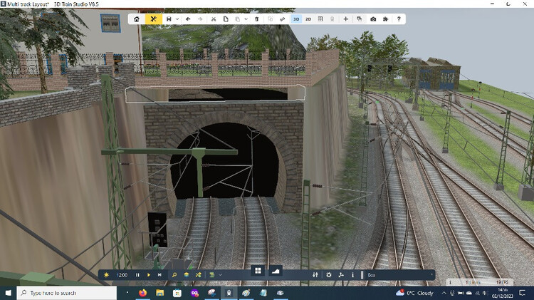

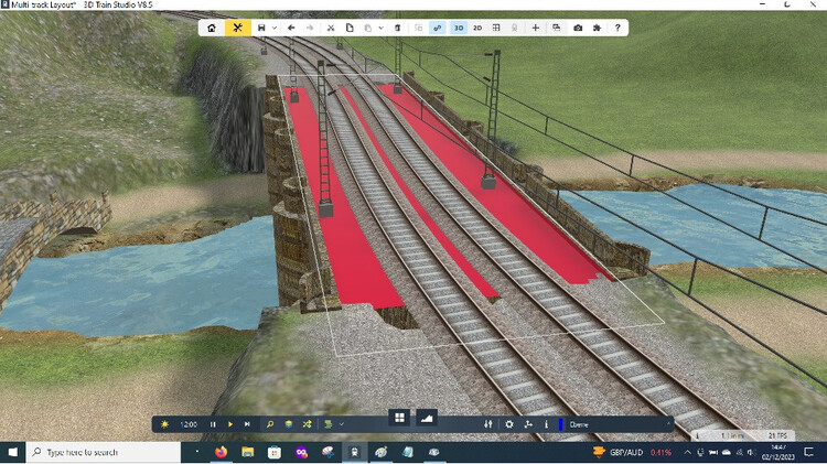

In the primitives' menu, you can find a variety of flat shapes and solid shapes. I've used these in the past to construct quite detailed buildings. But for this purpose, consider the flat rectangle "Ebene".
Not particularly impressive?  But position it right, just below the ground level (I use the1:1 scale track and baseboard, so it goes 5mm lower), size it correctly and colour it, and we get this:
"Ah," I here the perfectionists say, "But you still have a gap there on the right!"
Ah, yes. But this is where the box comes in

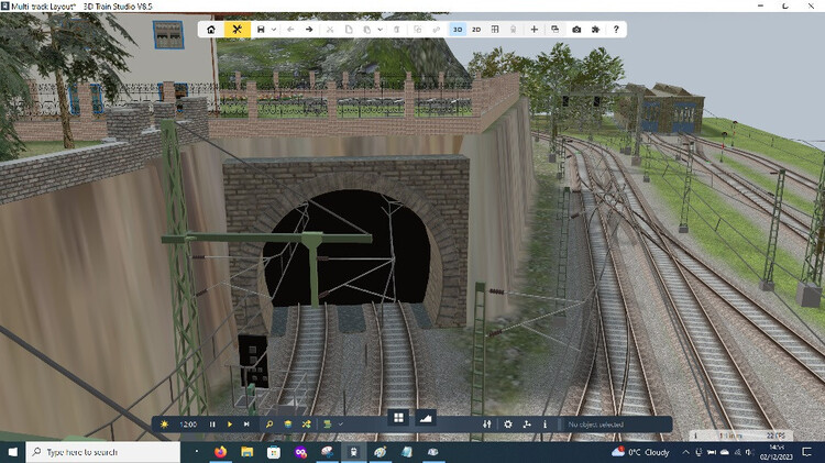

A bit of fiddling with the edges of the embankment, and it all looks the way I want it to.

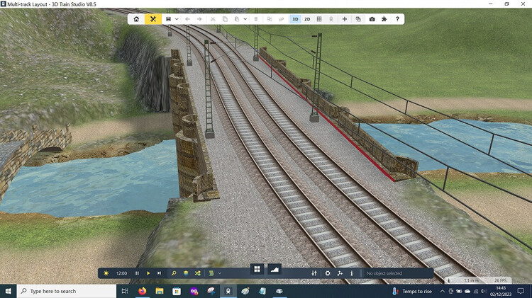

The above pics were on a dummy layout. Here are a couple of examples from the layout I'm building:Bridge1A.thumb.jpg.cd05f4d78a8f26d64d411d4fc3818e99.jpg
Bridge1B.thumb.jpg.dc1e17dc736efde6d939f349abd1d245.jpgBridge1B.thumb.jpg.901d1791546d78c389e99faf5aefd1a8.jpg

I'm that one person ... been fighting that scenario for quite some time ... bingo a solution I overlooked !
Thank you simonjackson196
