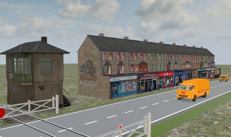

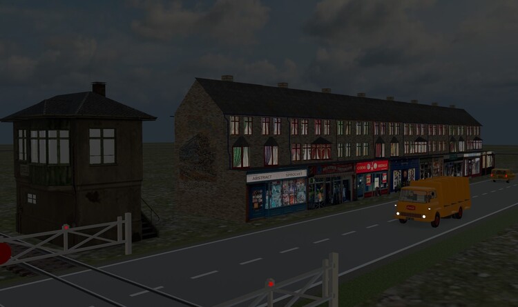

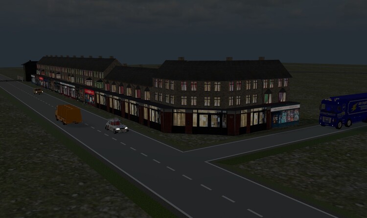

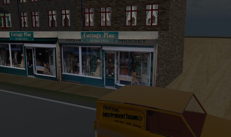

Further explanation...
I am making models of terraced shops, often seen on UK streets. I have one base model, with three variants (different windows...), which all use common Textures, made with Photoshop, for Colour, Metallic, Roughness and Emissive. With Photoshop, I use Layers to have different parts available, like a construction kit, to compose base Colour, Shop Front, the Curtains, Wall style, Roof style, and faded 'ghost' wall Posters. I can 'dial in' any combination, to give hundreds of different buildings, with either common features (all the same brickwork, for example...) or all different, simply by selecting the combination of Photoshop layers. This works well, and I have a stock of fifty or so different shop fronts.
These Textures could be used as '_Custom' Exchange textures, so that one model, with the three window variants, could have many different textures, by Exchange. This works well, too, except for the Emissive Texture, which remains constant, whatever Exchange Texture is imported. As I use the Emissive to light up the Shop Front and the curtained Windows, this can't work, as the Shop Front and Curtains will mix, badly, and the effect is lost.
A simple solution is to forego the use of Emissive, and use Exchange Textures with no night lighting. I think that a better solution could be to have Exchange Texture import to include Metallic, Roughness and Emissive files, if they are present. Without this, I have to create many variants (the model in the screenshot is only one Brick/Roof version, but already has twenty-four variants, to have eight shop fronts. Is the importing of all the Material files really impossible, or could it be implemented in a future version, please..?

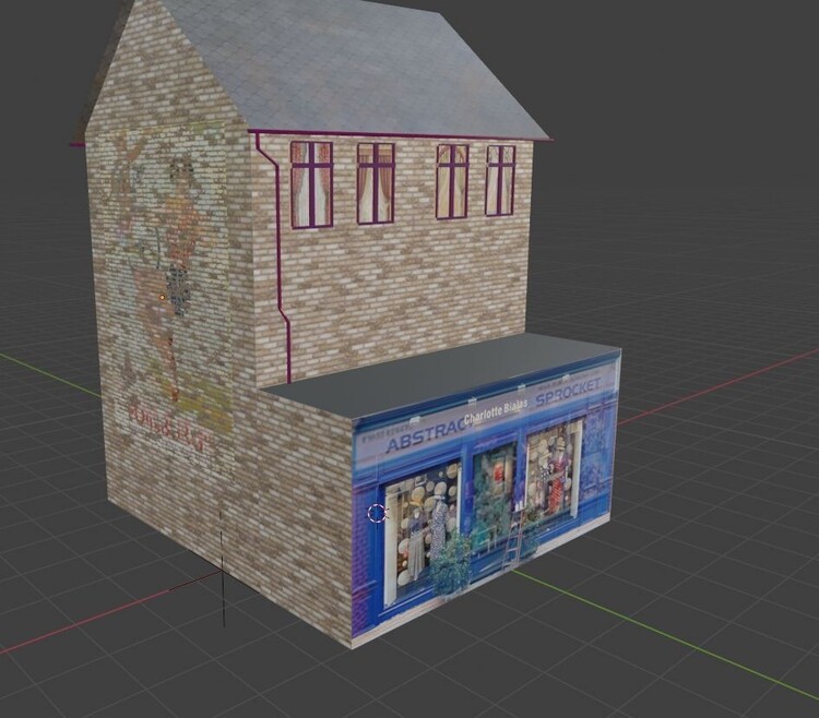

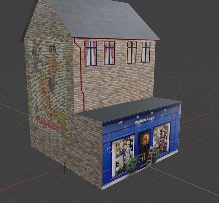

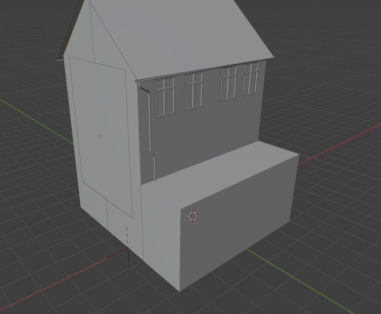

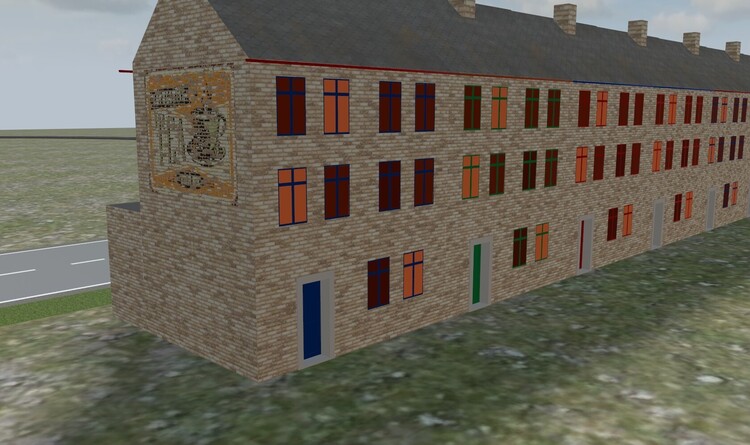

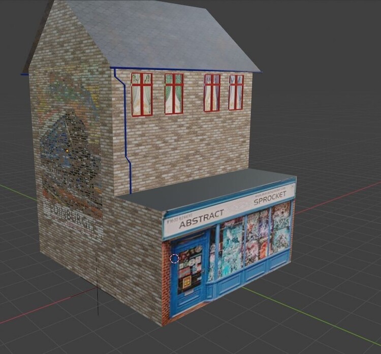

Alas, Pete, it doesn't work that way. Here's a 'naked' shop...
... and a 'dressed' one ...
Now with another Texture, we see that there is no 'Door' in the model, all is illusion...
Here we see what happens if the Emissive file is wrong (the shop front and windows are mashed together...)...
Not good, eh..? No such problem if I forget about Emissive lighting, but it works so well, and costs MBS nothing..!
It's, of course, possible, and indeed easy, to have opening doors in any one model with a fixed shop front, or that have compatible Textures. Hope this explains things a little...
